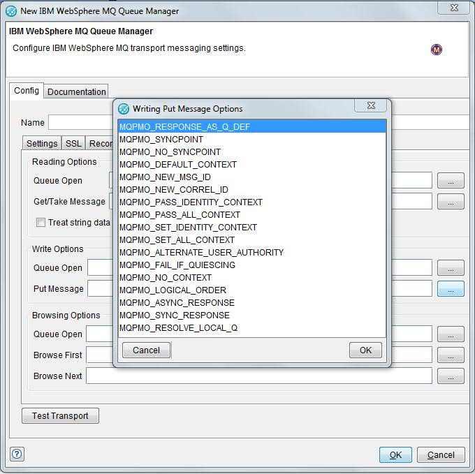

Specify the MQ transport queue IDs that must be used for reading, writing, and browsing the messages by using the Options tab.
The Options page of the MQ transport.
To specify the queue options for reading, writing or browsing the messages, do the following steps:
  1. Click More button to select the options that are supported for the operation. For reading, select one of the Reading Queue Open Options that start with "MQOO_INPUT_". The default is MQOO_INPUT_SHARED. For writing, select MQOO_OUTPUT. For browsing, select MQOO_BROWSE.
  2. Click OK. The selected options are converted into a decimal value, which is displayed in the field.
