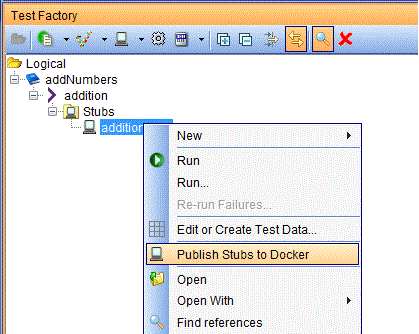

Publishing the stub to Docker
You can publish stubs that are created in HCL OneTest™ API to a Dockerfile and build context if the stub is based on a supported transport.
In the Test Factory perspective, right-click the stub and click
Publish Stubs to Docker.

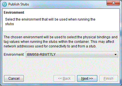

Select an environment for HCL OneTest™ API to use
while running the stubs.
- Click Next.

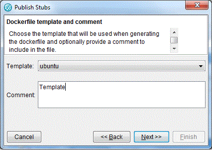

Select a template.
By default, HCL OneTest™ API provides a template, which is based on Ubuntu. This template provides the runtime and files that are necessary to run the stub. Optionally, you can provide a comment.
- Click Next.

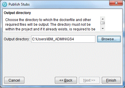

In the Output Directory dialog, click Browse to
select an empty folder to publish the Dockerfile and the other supporting files.
If the folder does not exist already, HCL OneTest™ API creates it.
Click Finish.
A status message informs you that the Docker artifacts were published to the output directory specified.
Click OK.

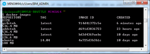

Building a Docker image of the stub
You will learn how to build a Docker image of the stub from the files in the output directory.

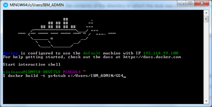

- Open the Docker Quickstart Terminal.
Run the following command:
docker build -t gs4stub c:\Users\IBM_ADMIN\GS4
If the image is built successfully, you can see a message similar to the following at the end of the status message: Successfully built 914d41372c5e
To verify that the Docker image of the stub is successfully built, run the following
command:docker images

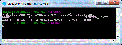

- Optional:
To verify that it is the additionStub that has been built into the
gs4stub image, run the following command:docker run
--entrypoint cat gs4stub /stubs.info
You have built a Docker image of the published stub.

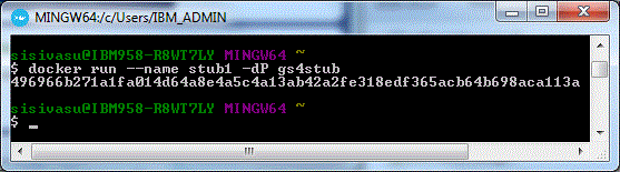

Run the following command:docker run --name stub1 -dP
gs4stub
The long string that is displayed is the unique ID that Docker has assigned to the container in which the stub is running.

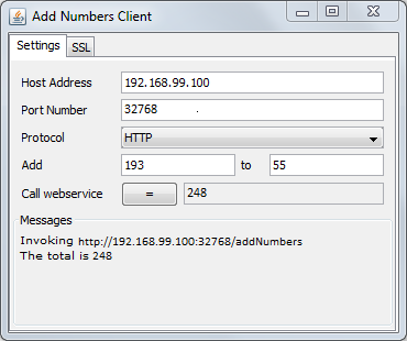

Verifying that the Add Numbers client is calling the stub
You must have successfully completed running the stubs in a Docker container.
Find the IP address of the Docker machine on which the stub is running. To do so, run the
following command:docker-machine ip.
Note down the IP address, for example, 192.168.99.100.
- Open the Add Numbers client.
- In the Host Address field, enter the IP address you noted down in Step 1.
- In the Port Number field, enter the port number you have noted down in Step 2 of Running the stub in a Docker container, for example, 32768.
Click the equal sign to run the add operation and verify the result.
You have verified that the Add Numbers client is calling the stub running in the Docker container.

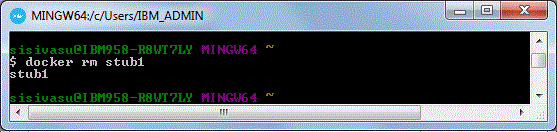

Stopping the stub and remove the Docker container

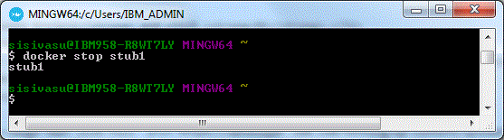

To stop the stub, run the following command: docker stop
stub1
To remove the Docker container, run the following command:docker rm
stub1
You have stopped the stub running in the Docker container and also removed the Docker container.
