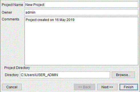

  1. In the startup window, select Create Project and click OK.
  2. Enter a name for the project in the Project Name field.
  3. Click Browse and select a location to save the project.
    If you do not browse and select a location, the project is saved in the default location, which is your home directory. For example, the default location is C:\Users\USER_ADMIN.
    Image of the new project window.
  4. Click Finish.

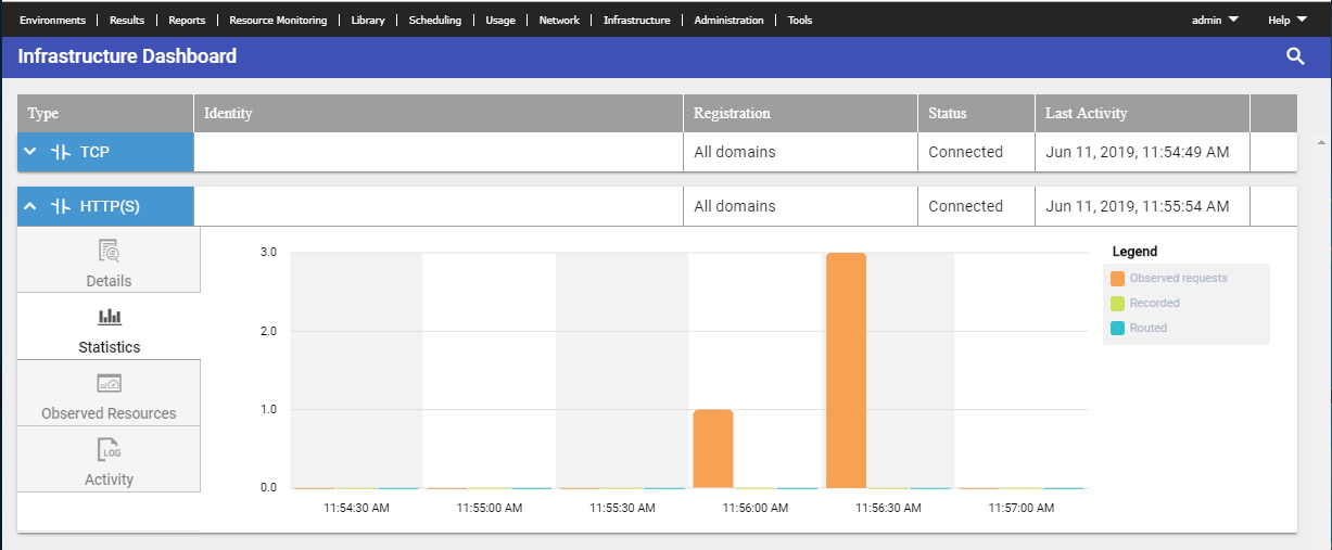

  3. Click the Infrastructure icon on the HCL Quality Server Home page to view the connected agents or proxies.
    Image of the HCL Quality Server Home page.
    Two entries are listed on the Infrastructure page, one for the HTTP/TCP Proxy’s HTTP and HTTPS proxy capability, and the other for the HTTP/TCP Proxy’s TCP proxy capability. You can view the requests received by the proxy from the Statistics panel. You can also view the activities that were logged from the Activity panel.
You have verified that the Add Numbers client application is using the HTTP proxy.

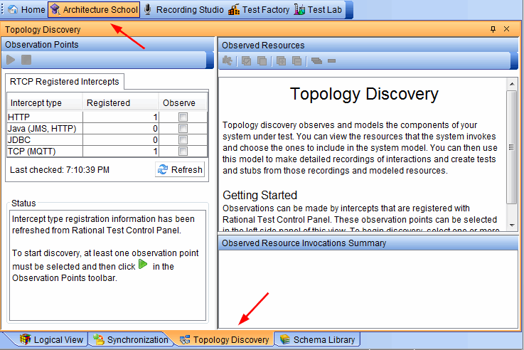

  1. Return to HCL OneTest™ API Home page, and on the toolbar, click Architecture School.
  2. Click the Topology Discovery tab.
    Image of the Topology Discovery tab.

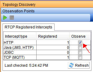

  3. The Observation Points panel lists the Topology Discovery intercept types that are registered with HCL Quality Server. If the HTTP/TCP proxy has started you can see 1 against both HTTP and TCP. To discover the HTTP endpoints, select the check box next to the intercept type, HTTP.
    Image of the Observation Points window.
  4. Click Start discovery.

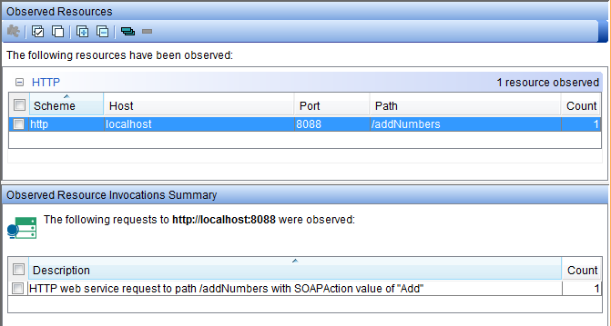

  6. Return to HCL OneTest™ API. After a few seconds, you can see a new line being displayed in the Observed Resources panel, which describes the Add Numbers server endpoint to which the request was sent.
  7. Click the row to see the information about the request that was observed.
    In the Observed Resource Invocation Summary panel, the description shows HTTP web service request and that it had a SOAPAction value of Add. This view summarizes large numbers of endpoints and invocations. You can use it to observe all the activities in a large, complex system, and find the endpoints that you are interested in testing or virtualizing.
    Image of the Observed Resources window.

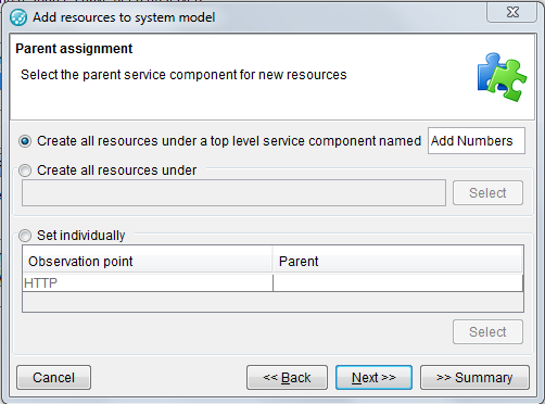

  11. On the Parent assignment page, choose a name for the new component to contain the observed operations. As the application observed is called Add Numbers, enter the same name.
    Image of the Add resources to system model window.
  12. Click Next.

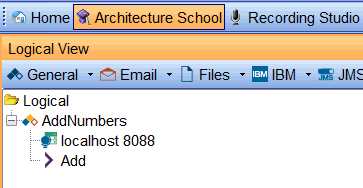

    In the Logical View, you can see the component named AddNumbers containing an operation named Add that you observed, along with the localhost 8088 HTTP transport that the operation used.
    Image of the AddNumbers component in the Logical View perspective.
You have discovered the endpoints used by the HTTP proxy when running the Add Numbers client application.

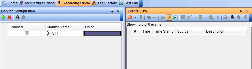

  1. Click the service operation called Add, to select it.
  2. Click Add event monitors for the selected items on the toolbar.
    HCL OneTest™ API switches to the Recording Studio perspective and adds an Event monitor for the Add operation, which you can see in the Monitor Configuration panel.
    Image of the Events View window.
    1. You are prompted to add a monitor for the localhost 8088 HTTP transport.
      You use such a monitor to record traffic for all the operations on that transport apart from those for the Add operation.
    2. As you want to record traffic for the Add operation alone, you can leave all the options with their defaults and click OK.
      The Monitor Configuration panel shows one row, which in the Monitor Name column indicates the Add operation.
    3. To remove other monitors, select them and click the Delete the selected monitors icon.

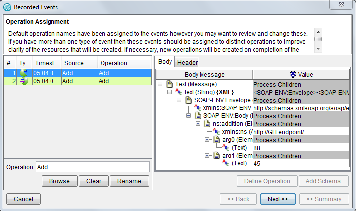

    You can find the two events that represent the request for 88+45 and its response of 133. These events are the first two events in the table.
  8. Select these two events in the Events View; to do so, click the first one, hold down the Shift key and click the second one.
    The descriptions of the events displayed are: POST /addNumbers and 200 – OK
  9. In the Events View toolbar, click the Create Stub from selected events icon.
    This action opens the Recorded Events wizard where you can use the selected events to create a stub. The Operation Assignment page shows the events and that operation they are related to.
    Image of the Recorded Events window.
  10. Click Next.
    On the Transaction Assignment page, you control which request is grouped with which reply. In this case, you have only one request and reply, so they are put together into Group# 1.
  11. Click Summary.

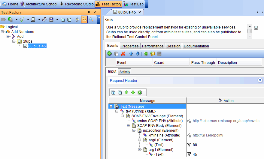

  12. Enter the stub name as 88 plus 45.
  13. Click Finish.
    The stub is opened in Test Factory.
    Image of the Stub window.
You have recorded requests and responses from the Add Numbers server and used them to create a stub that can listen to the request for one of the operations you recorded and returns the result that you recorded from the server for that request.

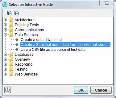

    When virtualizing a real system, you create a more complex stub that either eliminates the need for the real server to be running when testing is in progress, or that simulates a difficult-to-recreate scenario. For example, an error case from the server application to aid testing of how the client application deals with such cases. For references on creating more complex and flexible stubs, see What to do next.
    An option is to use a data source from which a stub can look up data based on the message it received. For instructions on how to create a data-driven stub, complete the following steps:
    1. In the HCL OneTest™ API Home page, click Help > Interactive Guides.
    2. Click Select an Interactive Guide.
      Image of the Interactive guides list.
    3. Select Data Sources > Create a Stub that uses data from an external source and click OK.
      Image of the Select an Interactive Guide window.
    4. Follow the steps in the Interactive Guides view.
You have successfully created, run, and verified a virtual service (message-based stub) that uses an HTTP proxy as a transport for messages.
