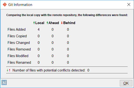

  4. Hover your cursor over the Git icon and numbers to view the location of the Git repository connected to HCL OneTest™ API displayed as a tooltip: image showing the tooltip with location of repository.
  5. Click the area with the Git icon and numbers, to view the details of the files in the repositories and files that are in conflict.
    The Git Information window is displayed as shown in the following sample image.
    image showing the Git information window.
    The details of the files in the local repository that are modified with respect to the files in the remote repository are shown in the following table.
    Status
    Description
    Local
    The details of the files in the local repository.
    Ahead
    The details of the files in the local repository that are modified with respect to their version on the remote Git repository. The files in the local repository have changes that are not committed or pushed to the remote repository.
    Behind
    The details of the files in the remote Git repository that are modified with respect to their version on the local Git repository. The files in the remote repository have changes that are not yet pulled into the local repository.

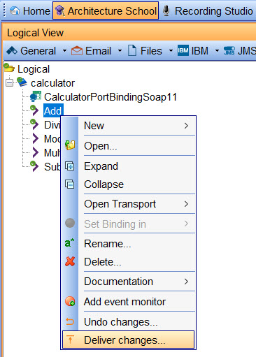

  2. To use the Git options in the Logical View (Tree View) of the Architecture School perspective, complete the following steps:
    1. Open the Logical View in the Architecture School perspective and select the tree view.
    2. Select the test asset that contains the changed file, right-click, and then click Deliver changes.
      You can identify the changed file if it is prefixed with the image of the icon icon.
      Image of the Git menu options in the logical view.
      The changed files are listed as selected in the Deliver changes dialog box.

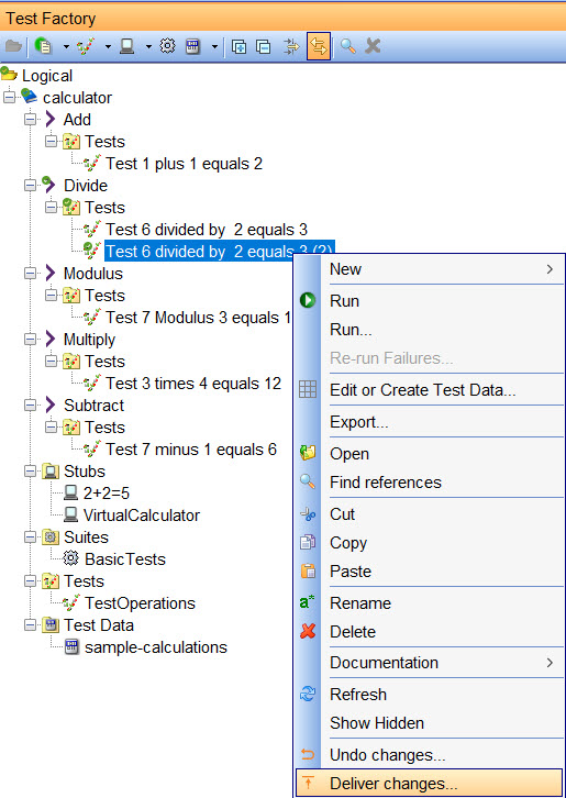

  3. To use the Git options in the Test Factory perspective, complete the following steps:
    1. Select the test asset that contains the changed file, right-click, and then click Deliver changes.
      Image of the Git menu options in the test factory view.

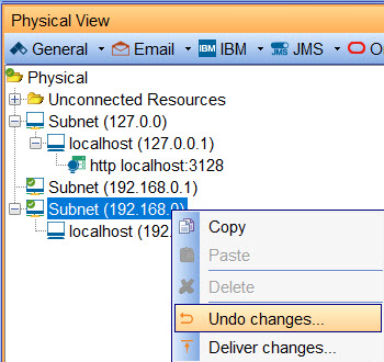

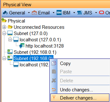

  4. To use the Git options in the Physical View of the Architecture School perspective, complete the following steps:
    1. Open the Physical View, select the test asset, right-click, and then click Deliver changes.
      Image of the Git options in the physical view.
      Note: Using the Git menu option to deliver changes selects all the resources under that test asset that you selected. You can clear the selected resources by using the Clear All Image of the select all icon icon or by selecting the check box of the resource that you want to clear. You can select the resources that you want by selecting the check box or use the Select All Image of the select all icon icon to select all the resources listed.
    2. In the Deliver changes dialog box, enter text in the Commit Message field.
    3. Click OK.

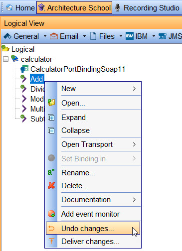

Undoing changes in the local repository
You can check out the project files from the remote Git repository to your local repository by using the UI options in HCL OneTest™ API. Use this option when you have uncommitted changes in the project files on your local Git repository and you want to ignore those and reload the project using files from the remote Git repository.
  • Set up the Git repositories.
  • Ensured that the project files exist in the local repository.
  • Opened the project from the local repository.
  • Made changes in the project for the files to show as changed in the HCL OneTest™ API UI.
Tip: You can check whether the repository is connected by looking at the Git icon image of the icon displayed in the Status bar.

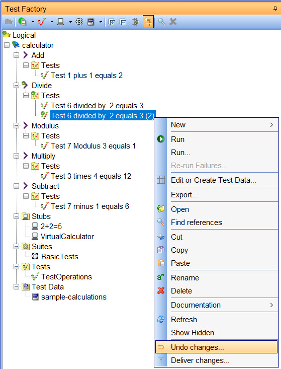

You can undo changes in your project files in the local repository by checking out the files from the remote Git repository. When you perform the Undo changes action in your project, the open editors in your project are refreshed and the files in the local repository are updated. All files that you had changed are discarded and are replaced with the files from the remote repository.
  1. To use the Menu option, complete the following steps:
    1. From the Menu, click Tools > Undo Changes.
      The changed files in the local repository are listed as selected in the Undo changes window.
      Note: Using the Menu option to undo changes selects all the resources that have changed in the project. You can clear the selected resources by using the Clear All Image of the select all icon icon or by selecting the check box of the resource that you want to clear. You can select the resources that you want by selecting the check box or use the Select All Image of the select all icon icon to select all the resources listed.
    2. In the Undo changes window, click OK.
  2. To use the Git options in the Logical View (tree view) of the Architecture School perspective, complete the following steps:
    2. In the tree view, identify the files that are changed and uncommitted files in the project, which are prefixed with the image of the icon icon.
      For example, if you have created a copy of a test and have not yet checked in the project files into the remote Git repository, the changed asset is displayed with the prefixed icon.
      image showing the tree view in the Logical View with the changed file
    3. Select the test asset that contains the changed file, right-click, and then click Undo changes.
      The changed files are listed as selected in the Undo changes window.
      Note: Using the Git menu option to undo changes selects only the resources under that test asset that you selected. You can clear the selected resources by using the Clear All Image of the select all icon icon or by selecting the check box of the resource that you want to clear. You can select the resources that you want by selecting the check box or use the Select All Image of the select all icon icon to select all the resources listed.
    4. In the Undo changes window, click OK.
    1. In the Test Factory perspective, identify the files that are changed and uncommitted files in the project, which are prefixed with the image of the icon icon.
      image showing the test factory view with the changed file
    2. Select the test asset that contains the changed file, right-click, and then click Undo changes.
      Note: Using the Git menu option to undo changes selects only the files under that test asset that you selected. You can clear the selected resources by using the Clear All Image of the select all icon icon or by selecting the check box of the resource that you want to clear. You can select the resources that you want by selecting the check box or use the Select All Image of the select all icon icon to select all the resources listed.
    3. In the Undo changes window, click OK.
    1. Open the Physical View, identify the files that are changed and uncommitted files in the project, which are prefixed with the Image of the icon. icon.
The changes that you made in your local project files in HCL OneTest™ API are discarded and the latest version from the remote Git repository is checked out into the local repository.

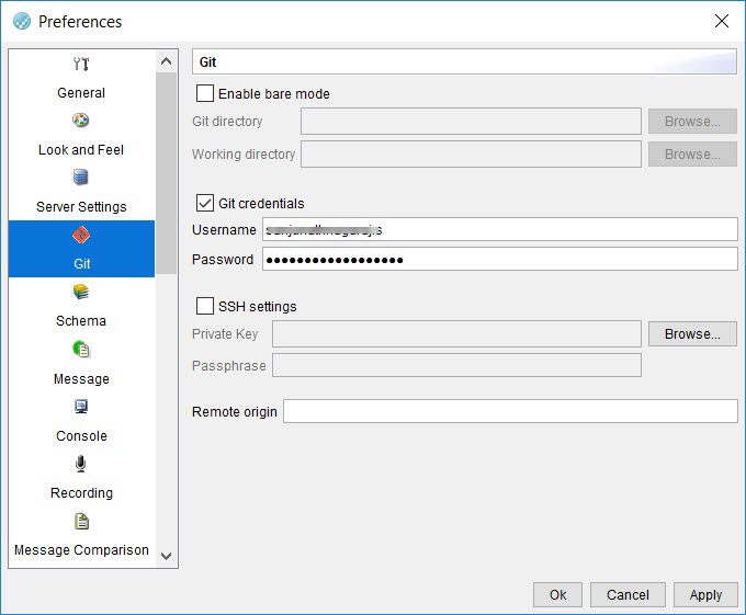

Setting preferences for Git
You can specify the Git directory and workspace when you are setting Git in the bare mode or specify your credentials to access the remote Git repository by using the Preferences option in HCL OneTest™ API. You can also configure the Secure Shell (SSH) settings or the name of the remote repository.
  1. From the Menu, click Project > Preferences.
  2. Click Git in the Preferences window.
    The git preferences window.
  3. Set up the Git repository in the bare mode by completing the following steps:
    1. Select the Enable bare mode check box.
    2. Enter the location of the Git repository that you want to set up as a bare directory. Alternatively, click Browse and navigate to the directory to select it.
      Note: You can use this option if you want to set up a bare Git directory without the project files. To set up a local repository, you must load the project files into the local repository by using your preferred method in Git before you open the project in HCL OneTest™ API.
    3. Enter the location that you want to use as the working directory or click Browse to navigate to the location.
  4. Set up your user credentials to enable access to the remote Git repository from HCL OneTest™ API by completing the following steps:
    1. Select the Git credentials check box.
    2. Enter your user name that you set for the remote Git repository.
    3. Enter the password for the user name.
  5. Set up the SSH communication between the client that hosts HCL OneTest™ API and the server that hosts Git by completing the following steps:
    1. Select the SSH settings check box.
    2. Enter the location of the Private Key that must be used to authenticate the client with the remote server. Alternatively, click Browse, navigate to the directory, and then select the Private Key.
    3. Enter the passphrase configured for the Private Key in the Passphrase field.
  6. Enter the name that you want to use for the remote repository in the Remote origin field.
    If you do not provide a name, the default name considered is origin.
  7. Click Apply, and then click OK to apply the preferences.
