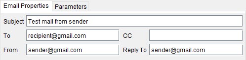

      Request/Reply
      The email properties tab that is displayed as follows:
      Note: When Publish/Subscribe action is selected, the email properties are displayed for the Publish action.
      Image of the email properties tab.
      • Enter text as the subject for the email message.
      • Enter the email address of the recipients of the email message in the To field.
      • Enter the email address of the sender or publisher of the email message in the From field.
      • Enter the email address of the recipients to which a copy of the message is to be delivered in the CC field.
      • Enter the email address of the recipients to whom a reply message is to be sent in the Reply To field.

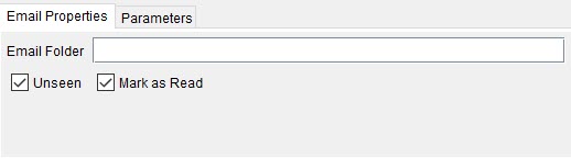

      The email properties tab is displayed as follows:
      Note: When Publish/Subscribe action is selected, the email properties are displayed for the Subscribe action.
      Image of the email properties tab for the Subscribe action.
      • Select the email transport.
      • Enter the name of the folder from which the email messages are to be subscribed to in the Email Folder field.
        For example, you can add Inbox as the email folder.
        Note: The email folder you specify here overrides the folder that you configured for the physical transport.
      • Retain or clear the selections for the Unseen or Mark as Read options.
        Note: The Unseen and Mark as Read check boxes are displayed as the default selections and the following default actions are performed when you subscribe to messages in the email folder:
        • The messages that are not yet seen or read by the recipient are subscribed.
        • The subscribed messages are marked as read in that email folder.
