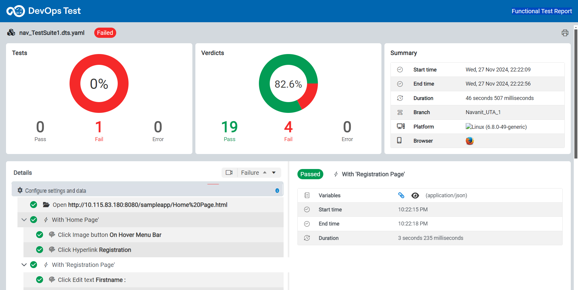

  5. Click the Functional Report link.
    The Functional Report opens in a new tab.
    You can see the following information in the report:
    • Click the Configure settings and data node to view the initial variable values and dataset details used during test run. Variable details are now displayed directly in the parent activity viewer for better readability and navigation.
    • The top-level steps and first-level child steps are automatically expanded to provide better visibility.
    • A summary of the test run, including passed or failed status, count of passed or failed tests or test steps, and the verification points.
    • A summary of the test environment with the details of deployments, datasets, and components.
    • A detailed view of all tests that were executed in the case of an intelligent test suite, or in the case of a test with invoked tests.
    • A detailed view of all steps that were executed for each of the tests, including screenshots if any.
