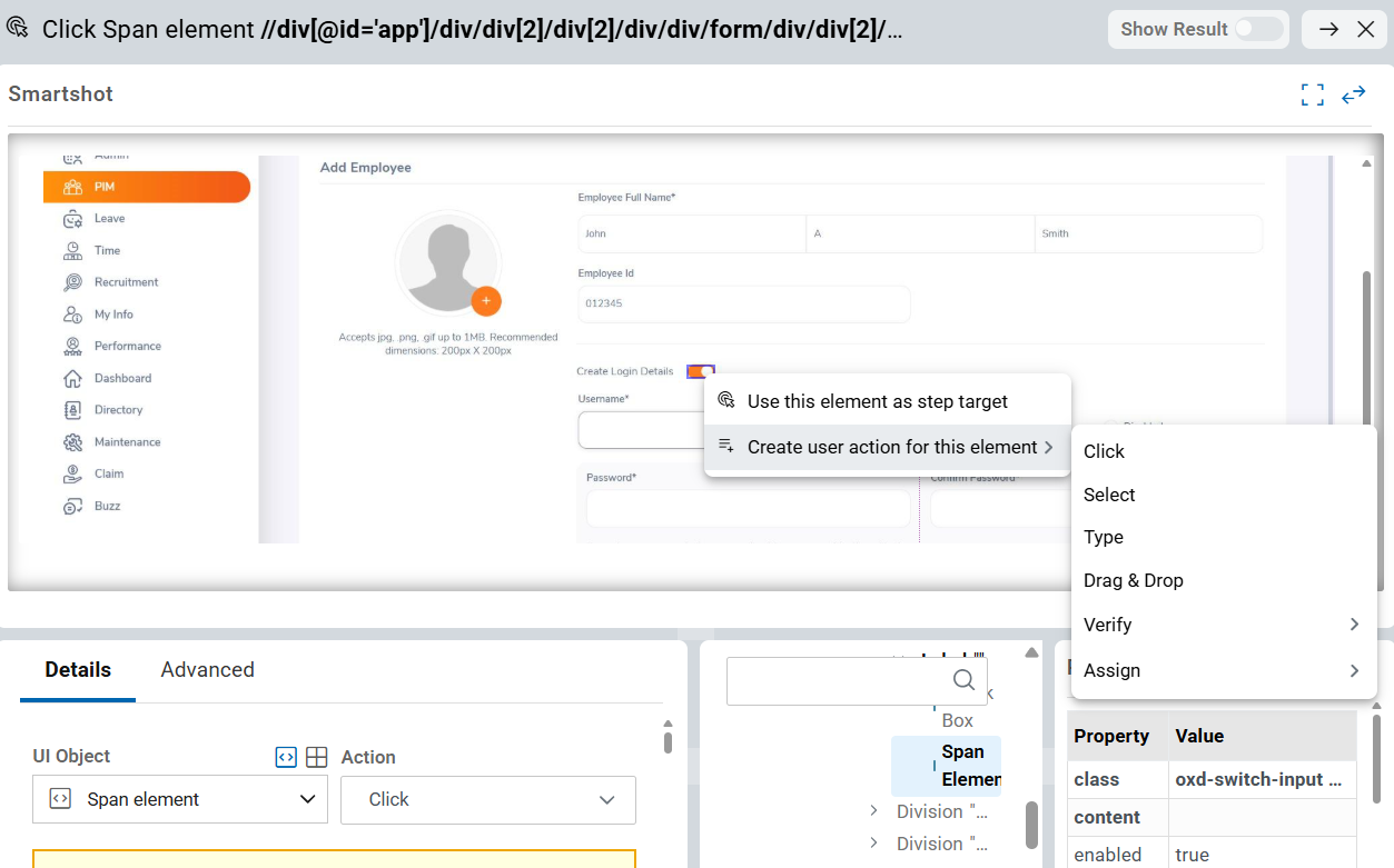

  1. Locate the recorded step Create Login Details, and then click it.
    The step opens in the Smartshot view tab.
  2. Click the Expand view icon Expand view icon for smartshot to expand the Smartshot view for better visibility.
  3. Select the Create Login Details toggle field.
  4. Right-click and select Create user action for this element > Verify. This allows you to add a verification that checks a specific property of the selected UI element. In this scenario, this step creates a verification point to check whether the Create Login Details UI element is enabled.
  5. Select enabled:true option from the displayed Verification points list.
  6. You can veiw the created the Verification in the Details tab.

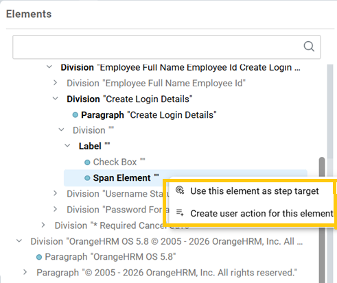

  7. Notice that once the UI element is selected in Smartshot, the same element is automatically highlighted in both the Elements panel and the Properties panel.
    • The Elements panel shows the UI elements captured in the recorded test.
    • The Properties panel displays the properties of the currently selected UI element.
    You can use either panel to add the same Verify step.
    • From the Elements panel, right-click the highlighted UI element and select Create user action for this element > Verify. For example, Span Element in the Elements panel.

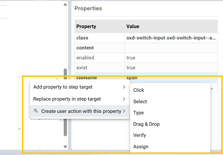

      You are creating a verification based on a specific property of the UI element, rather than the entire element.
    • From the Properties panel, right-click the tagName property and select Create user action with this property > Verify. For example, span.

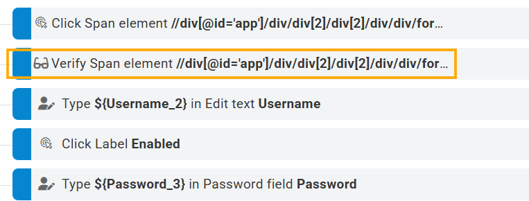

  8. Click Close to close the Smartshot.
    The Verify step is added to the recorded steps.
  9. Click Save to save the modified test.
You have added verification points to the recorded Create Login Details step.
