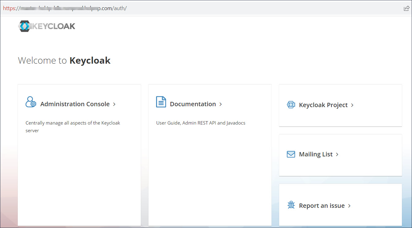

  2. Open Keycloak by entering /auth in the Address bar after the URL of your server instance, and then press the Enter key.
    For example, if the URL of the server instance is https://<myserver.mycompany.com>, add /auth after the URL as in https://<myserver.mycompany.com>/auth
    The Keycloak dashboard is displayed.

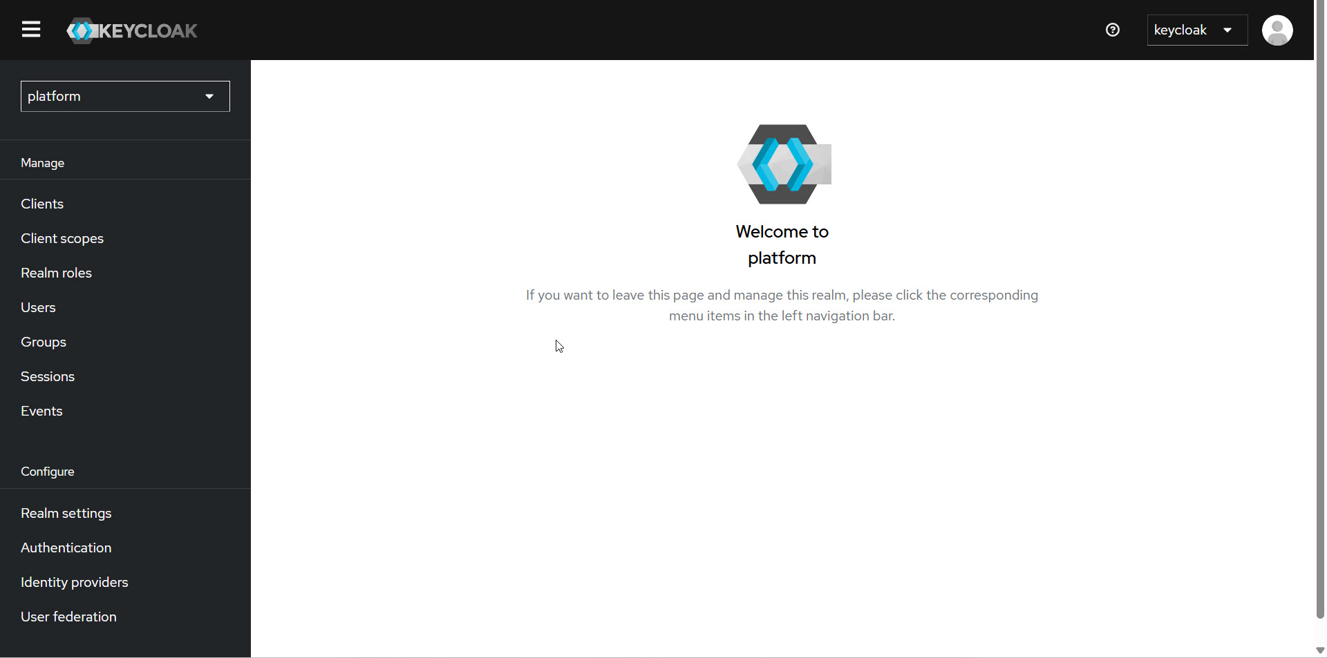

  5. Change the realm to platform, if it is not already in this realm.
    The platform realm dashboard is displayed.

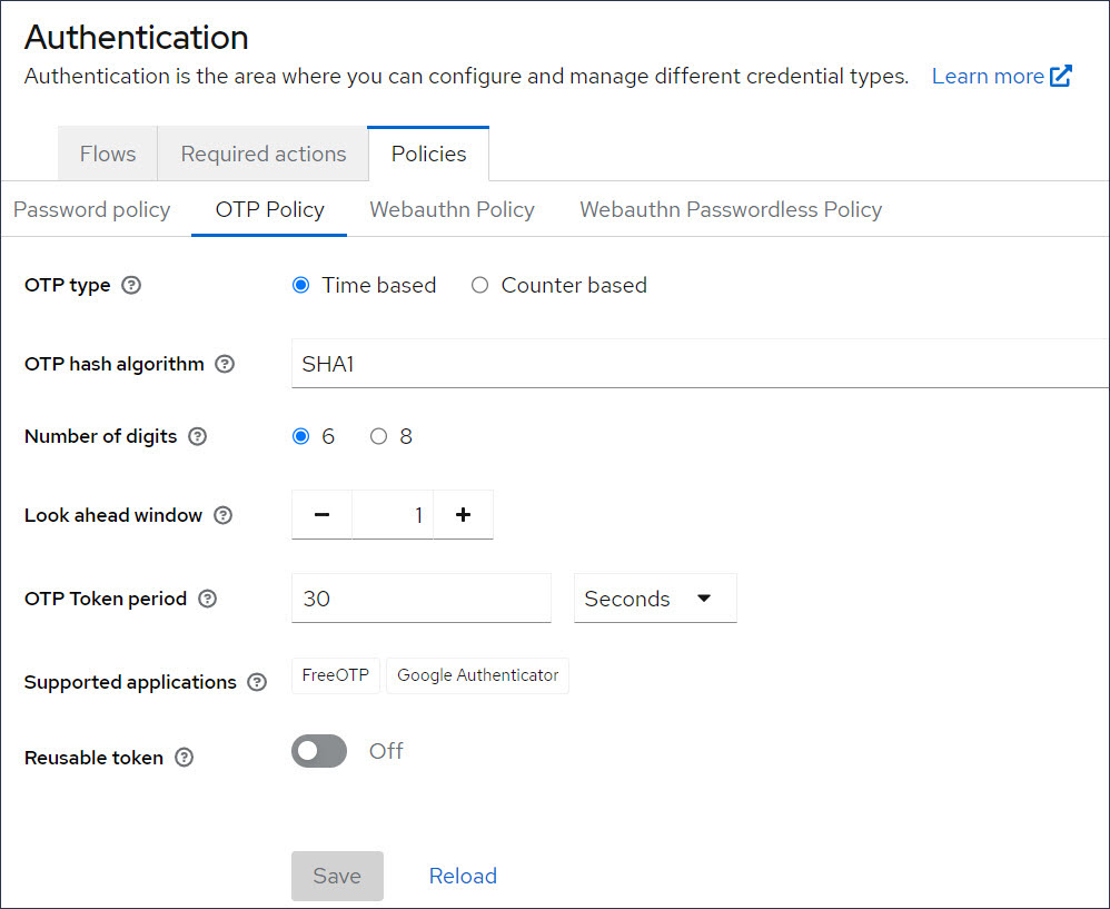

  7. Click the Policies tab, and then click the OTP Policy tab.
    The OTP Policy configuration settings are displayed.
    Image of the OTP policy settings.
  8. Read the description provided for each of the fields by clicking Image of the help icon. and decide the values that you want to set for each of the fields, which are different from the default values listed.
    You can save the changed configuration or use the default configuration without making any changes.
