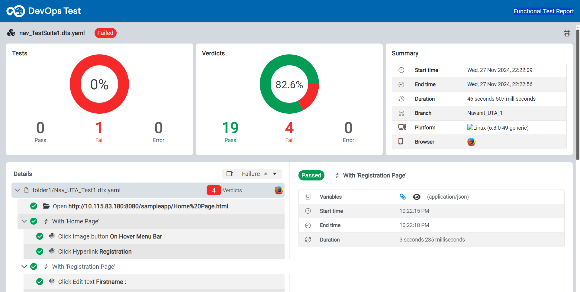

  5. Click the Functional Report link.
    The Functional Report opens in a new tab.
    You can see the following information in the report:
    • A summary of the execution, including passed or failed status, count of passed or failed tests or test steps, and the verification points.
    • A summary of the test environment with the details of deployments, datasets, and components.
    • A detailed view of all tests that were executed in the case of an intelligent test suite, or in the case of a test with invoked tests.
    • A detailed view of all steps that were executed for each of the tests, including screenshots if any.
