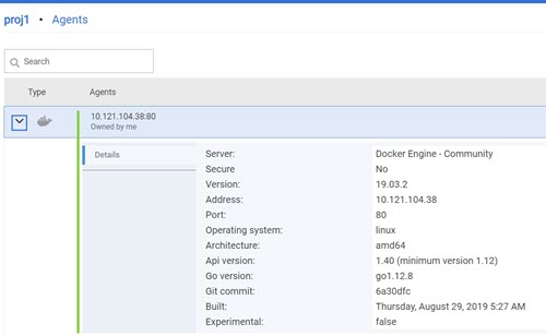

    You can view the details of the Docker host by clicking the Expand icon Image of the expand icon..
    Image of the agents page showing the docker details panel.
