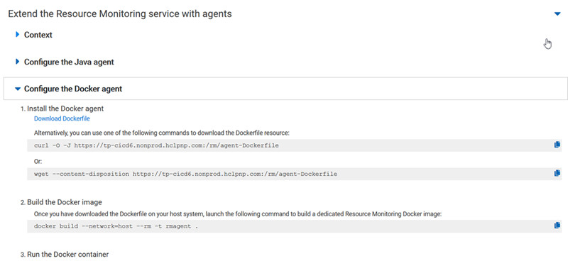

Click Set up Agents to extend Resource Monitoring
service link in Test Hub to access the
agents page where you can find the instructions and commands that are to be used
to install and run the agents.
Expand Configure the Docker agent and click
Download Dockerfile to download a Docker agent.
You can also use the curl or wget commands to download the agent without accessing the resource monitoring web UI.
For more facility, use the code snippets to copy and fill in the commands with the valid offline token and the Docker file name.
For Windows:
curl -O -J https://hostName/rm/agent-DockerfileFor Linux:
wget --content-disposition hostName/rm/agent-Dockerfile -
Copy the build command that is under Build the Docker
image, paste it in your console and run it to build a resource
monitoring Docker image.
Before you start the a Docker agent, you must build a Docker image.
docker build --network=host --rm -t rmagent -
