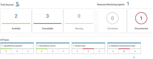

Click a source that is available in your project, either in the
Total Sources cards or in the All
Types cards from the resource monitoring page.

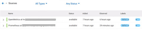

Click
under the Labels column of a resource monitoring
source to add a label.
Enter a name for the label and press the Enter key.
Example: Enter 'SUTv2' in three different resource monitoring sources.
Note: You can add one label or multiple labels for the same resource monitoring source. A label can contain a maximum of 200 characters.Tip: You can create the same label for different sources that belong to the same logical group to monitor the whole group with only one label. -

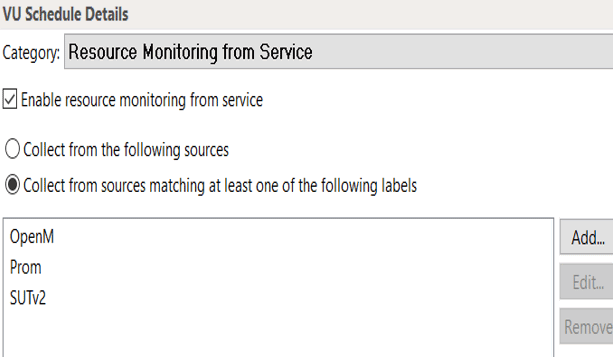

project (step 6). - If the Resource Monitoring from Service
option was enabled in Test Performance, and
data is collected from the sources you added to the performance
schedule in Test Performance (see
Figure 2), the Resource Monitoring tab displays
the list of these sources that are available in your Test Hub
project.

procedure). - If you added sources to your performance schedule by using labels in
Test Performance
(see Figure 3), the Resource Monitoring tab
displays the list of labels that are available in your Test Hub
project.
Figure 3:
To select resource monitoring labels from your schedule, follow step 6 in this procedure.

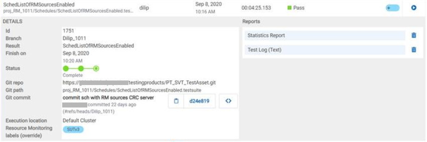

- Click the Result view in the navigation bar of Test Hub when the schedule is complete.
Expand the performance schedule result to see the resource monitoring label
name in the Details card.
The Details card displays the resource monitoring labels that are used in the schedule to override the initial labels and collect resource monitoring sources (in the example, the 'SUTv3' label). For other details about the Results page, see the link at the end of this page.

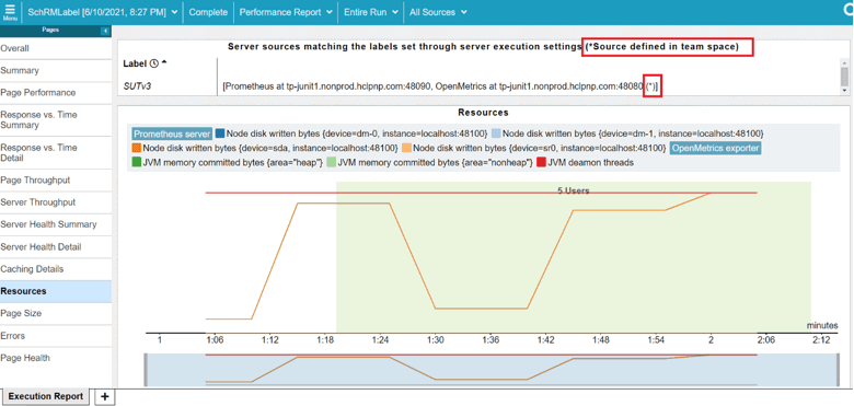

In the Report card, you find the link to the Statistics Report that is generated. In the Resource tab of the Statistics Report, you can view the information related to the Server sources matching the labels set in the schedule.
Click the Statistics Report link in the
Reports card to see the performance metrics of the
monitoring sources matching the selected labels.
Example: You can see the statistics for the sources tagged with the 'SUTv3' label.Note: In the Resources report, each resource name followed by an asterisk identifies a resource monitoring source that is defined in a team space.
