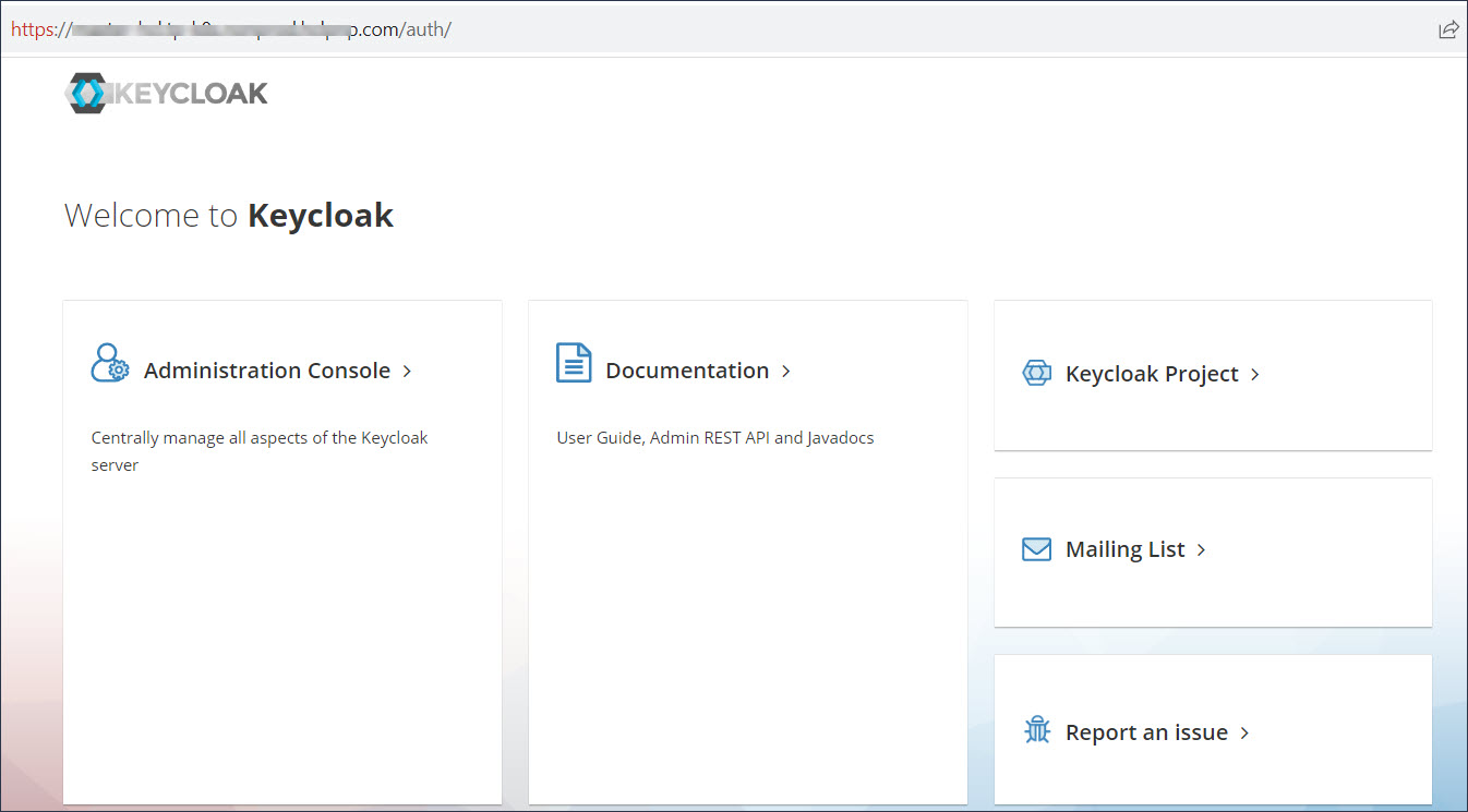

Open Keycloak by entering /auth in the Address
bar after the URL of your server instance, and then press the
Enter key.
For example, if the URL of the server instance is https://<myserver.mycompany.com>, add /auth after the URL as in https://<myserver.mycompany.com>/auth
The Keycloak dashboard is displayed.
- Click Administration Console.

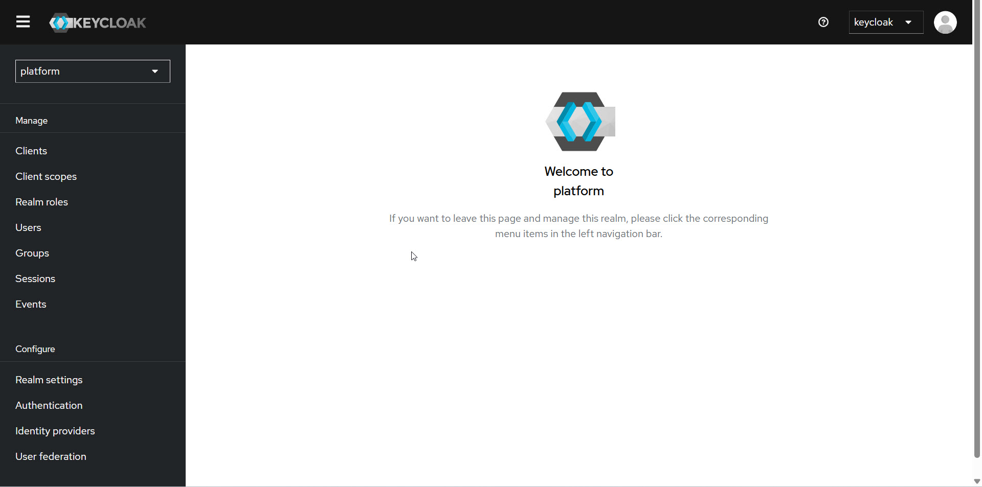

Log into the Keycloak administration console by using the default username as
keycloak and the password generated for you by Keycloak,
if prompted.
The Keycloak console is displayed.
Change the realm to platform, if it is not already in this
realm.
The platform realm dashboard is displayed.
Click Authentication in the navigation pane.

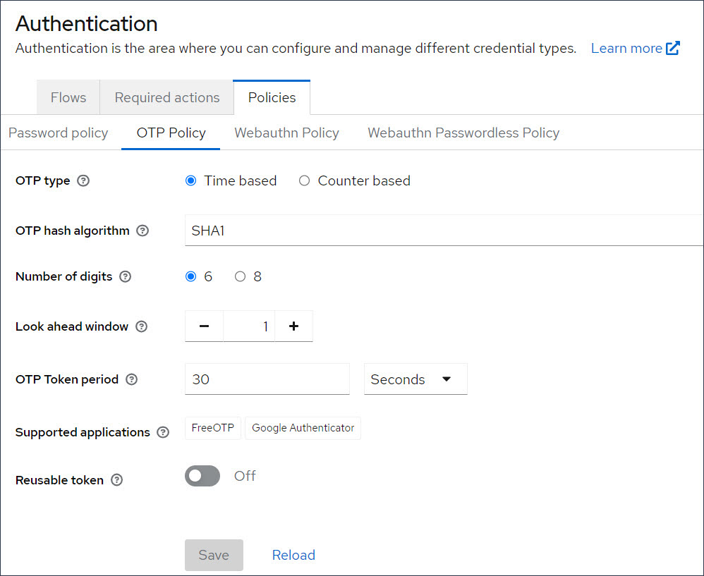

The Authentication page is displayed.
Click the Policies tab, and then click the
OTP Policy tab.
The OTP Policy configuration settings are displayed.
Read the description provided for each of the fields by clicking
and decide the values that you want to set for each of the fields,
which are different from the default values listed.
You can save the changed configuration or use the default configuration without making any changes.
You configured the settings or retained the default settings for an OTP policy in Keycloak.
