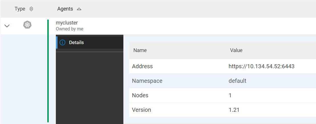

    You can view the details of the cluster by clicking the Expand icon Image of the expand icon..
    Image of the agents page showing the cluster details panel.
    The following table describes the details about the cluster:
    Name Description
    Address Specifies the address of the remote Kubernetes API.
    Namespace Specifies the namespace of the remote Kubernetes cluster in which the test runs occur.
    Nodes Specifies the number of nodes in the remote Kubernetes cluster.
    Version Specifies the Kubernetes version of the remote Kubernetes cluster.
