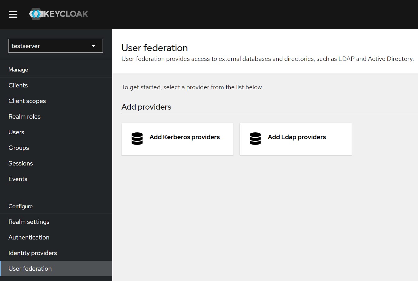

After you log in, you can go to the User Federation page to add your provider.
You must select the Add Ldap providers option and complete your LDAP/AD connection parameters.
