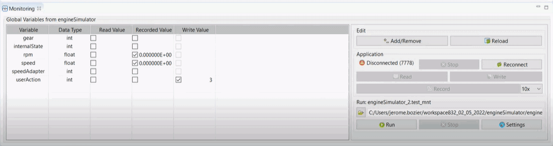

In the Project explorer view, right-click your project
file and select Open Monitoring to open the
Monitoring view.
Important:The Open Monitoring menu is available only if you have a .mnt file that was created when you built your project. If you can't see this menu, build your project.Note:In the Monitoring view, you can view all the global variables of your application that are not arrays. It is directly connected to the application that is running in background.
- Right-click your application .exe file in the Project Explorer view and select to start your application.
Click Reconnect in the Monitoring
view, under Application to connect to your application.
Note:You can stop the application whenever you want by clicking the Stop button but you must always restart your application before clicking Reconnect.
Select the variable values that must be monitored in your application:
- In the Read value column, select the variables
that the application must read and click
Read.
By clicking Read, the variable value displays in the Read Value column.
- In Recorded value, select the variables that must
be read cyclically in the application and click
Record. You can change the read process
frequency in the Record list. The selected value
is a multiplier factor that applies to the cyclic read frequency.
Note:The Recorded value column is displayed only if you set the Cyclic read allowed option to Yes in the variable monitoring build settings. If the cyclic read is not allowed, the Record is disabled. For more details, see Configuring the build and the monitoring settings.
- In the Write value column, enter new values and
select the variables that the application must read and click
Write.
By clicking Write, the variable value displays in the Read Value column.
Note:- Some write values can't be modified if you enabled the bit fields. In this case, the values are presented in gray.
- A control check applies to the write values. The column cell turns red if you enter a value with an invalid format, it turns yellow if the length of the value exceeds the size that is defined for the type of value.

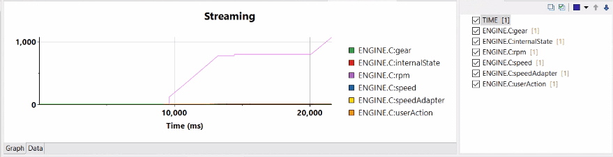

A graph view is displayed when you click Record so that you can examine the variable values usage in real-time in your application while the script is recording. You can work with the different menus that are available in the toolbar of the Graph view to change the graph format. In the Outline view, you can select the variables that are displayed in the graph. You can also change the color of the curves in the graph. - In the Read value column, select the variables
Read.
Click Stop Recording to stop the recording of the
monitoring script.
When you stop the monitoring process, the graph is saved in a .test_mnt file in your project.
