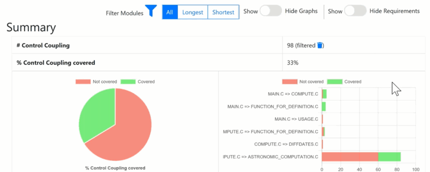

The Control Coupling report includes three parts.
Summary
In the Summary section, you find the number of Control Couplings for your application that are covered, given the information that you provided and the percentage of Control Couplings that are covered.
A graph displays the total percentage of covered and non covered control couplings for the entire application.
The Summary table displays the following information:
  • The percentage of Control Couplings of your application by module pairs that have not been covered, depending on the information that you provided.
  • The percentage of Control Couplings that are covered by module pairs.
Control Coupling Report - Summary

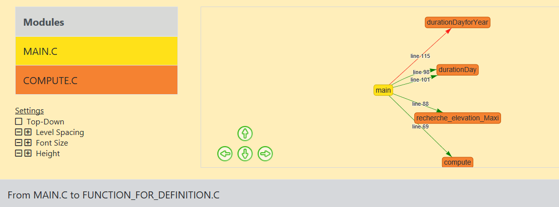

Call Graph
For each compilation unit, a partial call graph displays all the functions in an interactive call graph from left to right or from top to bottom, depending on the selector button position on the top of the call graph.
You can select a control coupling in the table to highlight it in the call graph.
Control Coupling Report - Call Graph
At the end of the report, a complete call graph displays all the functions calls.
