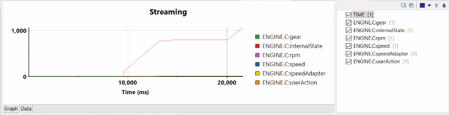

    A graph view is displayed when you click Record so that you can examine the variable values usage in real-time in your application while the script is recording. You can work with the different menus that are available in the toolbar of the Graph view to change the graph format. In the Outline view, you can select the variables that are displayed in the graph. You can also change the color of the curves in the graph.
  6. Click Stop Recording to stop the recording of the monitoring script.
    When you stop the monitoring process, the graph is saved in a .test_mnt file in your project.
