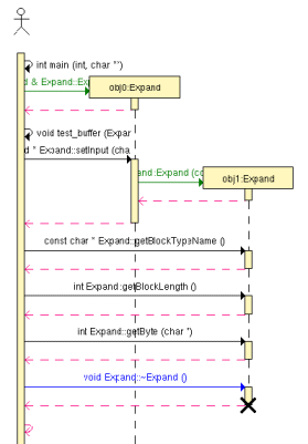

The lifeline of an object is represented in the UML/SD Viewer as shown below.
The instance creation box displays the name of the instance.
Example
Below is an example of object lifelines generated by Runtime Tracing from a C++ application.
In this C++ example:
Functions and static methods are attached to the World instance.
Objects are labelled with obj <number> : <classname>
The black cross represents the destruction of the instance.
Constructors are displayed as green arrow actions.
Destructors are the blue arrows.
Return messages are dotted red lines.
Other functions and methods are black.
Themain() is a function of the World instance called by the same World instance.
