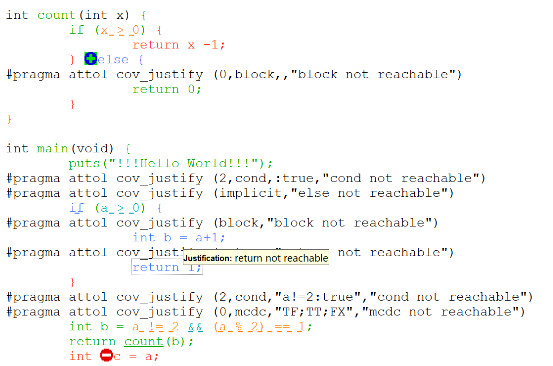

Source page
By default, the Source page of the coverage report displays covered and uncovered lines of code in the following colors:
  • Green for covered lines of code,
  • Red for uncovered lines of code,
  • Orange for partially covered lines of code,
  • Blue for justified lines of code,
  • Blue with the + icon for justified but covered lines of code, which means that they should not be justified.
  • Red with - icon for unreachable code.
You can change these colors in the code coverage report preferences. In the main toolbar, click Window > Preferences > HCL® OneTest™ EmbeddedViewers > Coverage viewer, you can modify the text color for the covered lines, covered lines with justify, justified lines, partially covered lines, and uncovered lines.
For non-covered line of codes that are justified, click on the blue attributes value to see more details about the justification text.
In C source files, the last bracket '}' in a function after a return statement is always displayed as uncovered in the coverage report, even if the function reports 100% coverage.

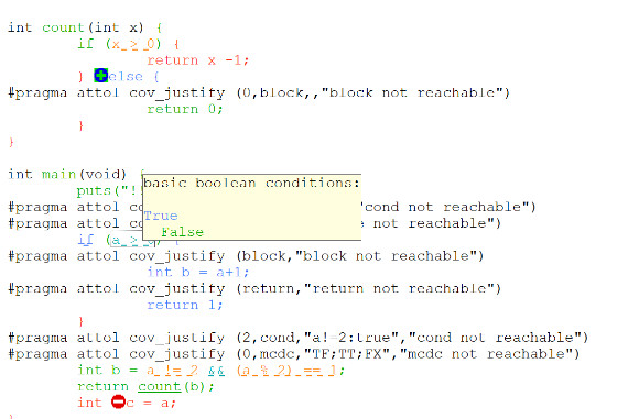

The Source page provides hypertext navigation throughout the source code:
  • Click a plain underlined function call to jump to the definition of the function.
  • Click a dashed underlined text to view additional coverage information in a pop-up window.
  • Right-click any line of code and select Edit Source to open the source file in the source code editor.
  • Some macro calls are preceded with a magnifying glass icon. Click the magnifying glass icon to expand the macro in a pop-up window with the usual coverage color codes.
