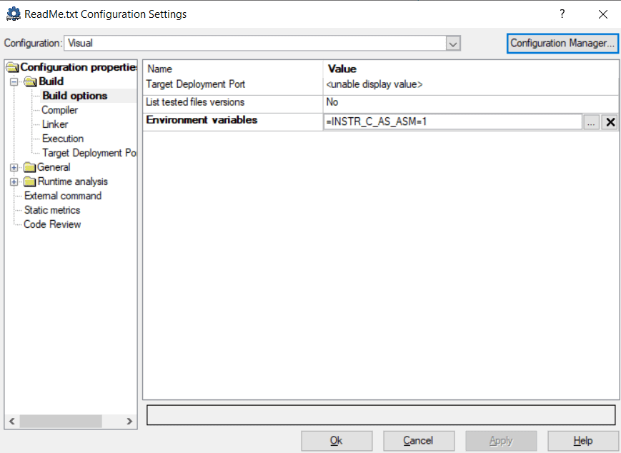

    To add this environment variable in Studio, proceed as follows:
    • Click Settings in the Project window.
    • Select Build options > Environment.
    • Click the Value field on the Environment variable line, and click ....
    • Click the Add icon, give a name to the variable, and enter INSTR_C_AS_ASM=1 in Value.
    • Apply and close the window.
    See the following example:
