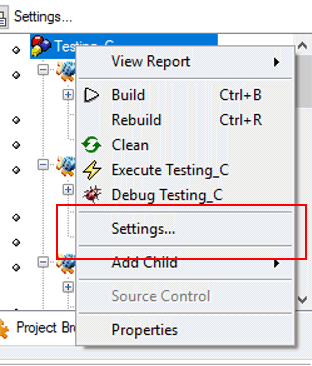

  1. From the Project Window view, select the project node.
  2. Right-click and select Settings

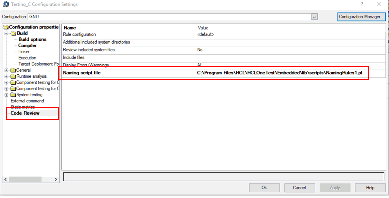

  3. In the window that opens, select Code Review, click in the Value column of the Naming script file option, and select the sample file that you installed: Example “NamingRules1.pl”.
  4. Apply and close the window.
