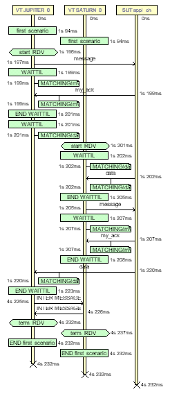

During the execution of the test, System Testing generates trace data this is used by the UML/SD Viewer. The System Testing sequence diagram uses standard UML notation to represent both System Testing results.
This is an example of a typical System Testing UML sequence diagram.

Virtual Testers and System Under Test
The system under test (SUT) and the Virtual Testers (VT) are represented as vertical instances. Messages sent and received by the Virtual Tester are represented along the Virtual Tester lifeline.
Messages
Messages are sent and received between Virtual Tester and system instances.
Rendezvous
RENDEZVOUS statements are displayed as Synchronizations in the Virtual Tester lifeline.
Test Script Events and Errors
Test script events and errors are represented as UML actions. Only significant instructions, such as INITIALIZATION, WAITTIL blocks and test errors are represented.
By default, errors appear in red. Other events are green.
WAITTIL blocks are displayed with their start and end events. Matching conditions are represented as notes. Use the mouse cursor tool-tip to get more information about the matching conditions.
