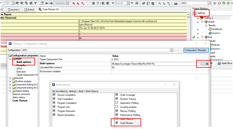

You can use the code review tool on any test or application node or a single source file. The code review tool is run on the source code whenever you build the file.
To enable the code review tool on a source file, test or application node:
- In Project Explorer, select the node that you want to review, right-click and
select Build > Build
options. Alternatively, click the Settings
button and select
Build
options. - Select Code Review.
To perform a code review without compiling and executing the application:
- In the Project Browser, select the node that you want to check.
- Select Build > Options from the menu or click the Settings
button and select
Build > Build
options. - Clear all build options and build steps (in the left) except Code Review.
- Click the Build
toolbar button. - Double-click the results in the Project Browser to open the report. If the report is already open, close the report and reopen it again.
