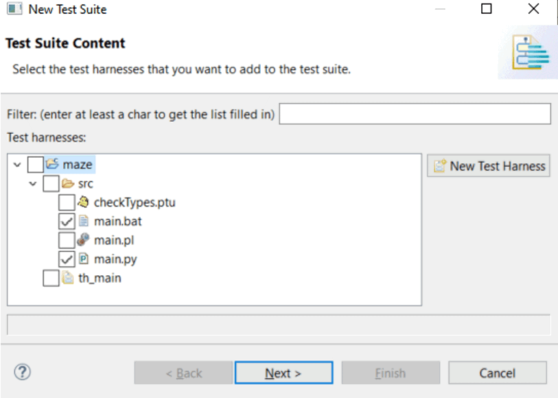

From HCL OneTest™ Embedded for Eclipse IDE v8.3.0, the Test Suite Content wizard automatically displays all the files that are available in your project and that can be run with the selected test harnesses: main test configuration files for test harnesses, .ptu files for PTU test scripts, .otd files for OTD test scripts, .bat files for Windows scripts, .pl files for Perl scripts, .py files for Python scripts (.py files), or .shell for Linux scripts.
To create a test suite:
  1. In the project explorer, right-click the project and select New > Test Suite.
  2. In the Create Test Suite wizard, select the test harnesses that you want to run together and the test scripts located in your project. Then, click Next.
  3. Select the main test configuration files for the test harnesses that are compatible with your test suite.
