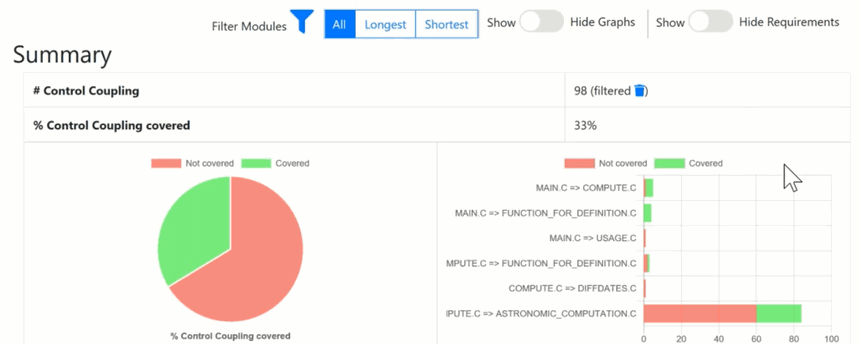

Summary
In the Summary section, you find the number of Control Couplings for your application that have been covered, given the information you provided and the percentage of Control Couplings that have been covered.
A graph displays the global percentage of covered and not covered control couplings for all the application.
- The percentage of Control Couplings of your application by pair of modules that have not been covered, given the information you provided.
- The percentage of Control Couplings that have been covered by pair of modules.

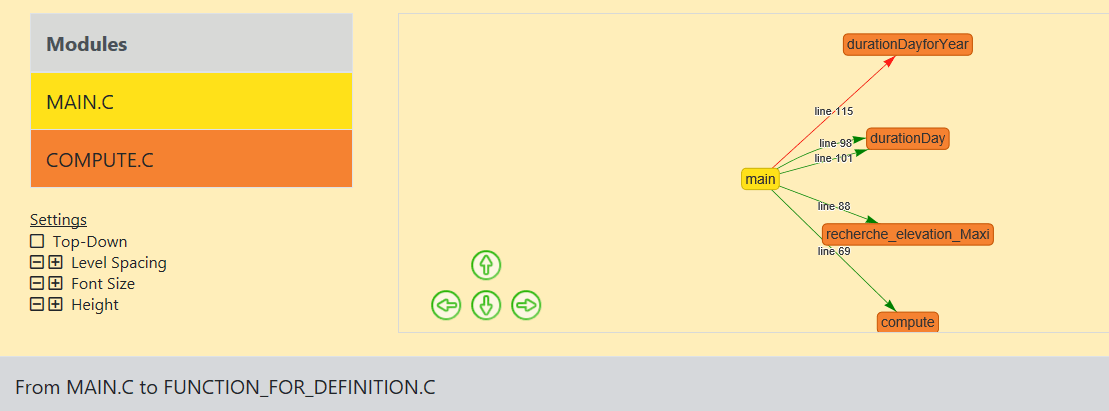

Call Graph
For each compilation unit, a partial call graph displays all the functions as an interactive call graph from left to right or from top to bottom, depending on the selector button position on the top of the call graph.
