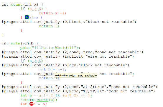

Code colors
- Green for covered lines of code.
- Red for uncovered lines of code.
- Orange for partially covered lines of code.
- Blue for justified lines of code.
- Blue with the + icon for justified lines of code, which means that they should not be justified.
- Red with - icon for unreachable code.
For uncovered line of codes that
are justified, click on the blue attributes value to see more details about the
justification text.
You can change the default colors in the code coverage report preferences. In the main menu toolbar, click , you can modify the text color for the covered lines, covered lines with justify, justified lines, partially covered lines, and uncovered lines.

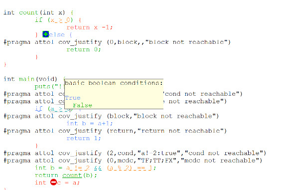

Hit Count
The Hit Count tool-tip is a special capability that displays the number of times that a selected branch was covered.
Hit Count is only available when Test-by-Test analysis is disabled and when the Hit Count option has been enabled for the selected Configuration.
To activate the Hit Count tool-tip:
In the Code Coverage Viewer window, select the Source tab.
From the Code Coverage menu select Hit. The mouse cursor changes shape.
In the Code Coverage Viewer window, click a portion of covered source code to display the Hit Count tool-tip.
