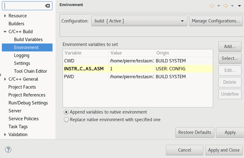

    To add this environment variable in Studio, proceed as follows:
    • Right-click on your project in the Project Explorer, and select Properties.
    • Select C/C++ Build > Environment.
    • Click Add, give a name to the variable, and enter INSTR_C_AS_ASM=1 in Value.
    • Apply and close the window.
    See the following example:
