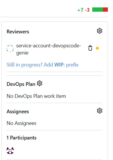

    2. Confirm that Code Genie shows a yellow dot next to its name, indicating the scan is running, and that the merge button is disabled.

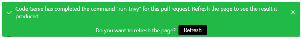

    3. Wait until a pop-up appears that tells Trivy scanning is completed. It usually takes around 20 seconds, but it depends on the size of the Control repository.

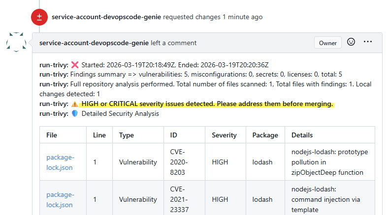

    4. Review the Code Genie pull request comments and confirm that HIGH or CRITICAL findings are blocking the merge, if the --reject is set to high.
    5. Address the security issues, push the fix, and allow Code Genie to re-run the scan.

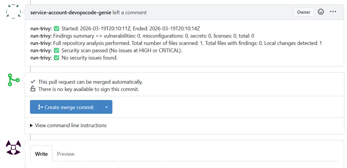

    6. Confirm that Code Genie approves the pull request after the clean scan and that the merge button becomes active.
