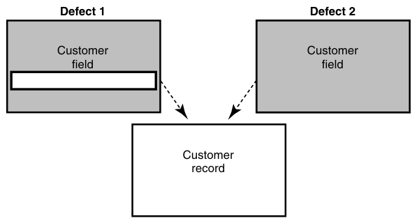

You can use REFERENCE or REFERENCE_LIST type fields to link records in order to share common data. To link two records, use a REFERENCE field. To link multiple records, use a REFERENCE_LIST field.
For example, you might have the same customer data that must be entered for multiple records (Sharing common data with REFERENCE_LIST fields ).
Figure 1: Sharing common data with REFERENCE_LIST fields
The image illustrates the use of reference list fields.

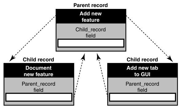

Linking records to create a parent/child hierarchy
You can use REFERENCE or REFERENCE_LIST type fields to link records of the same type to create a parent/child hierarchy. For example, you can relate a parent record that requests the addition of a new feature to one or more child records that describe related tasks, such as documenting the new feature and adding a new tab to the interface (Example of parent/child hierarchy).
Figure 2: Example of parent/child hierarchy
The image illustrates the relationship between parent and child records.
