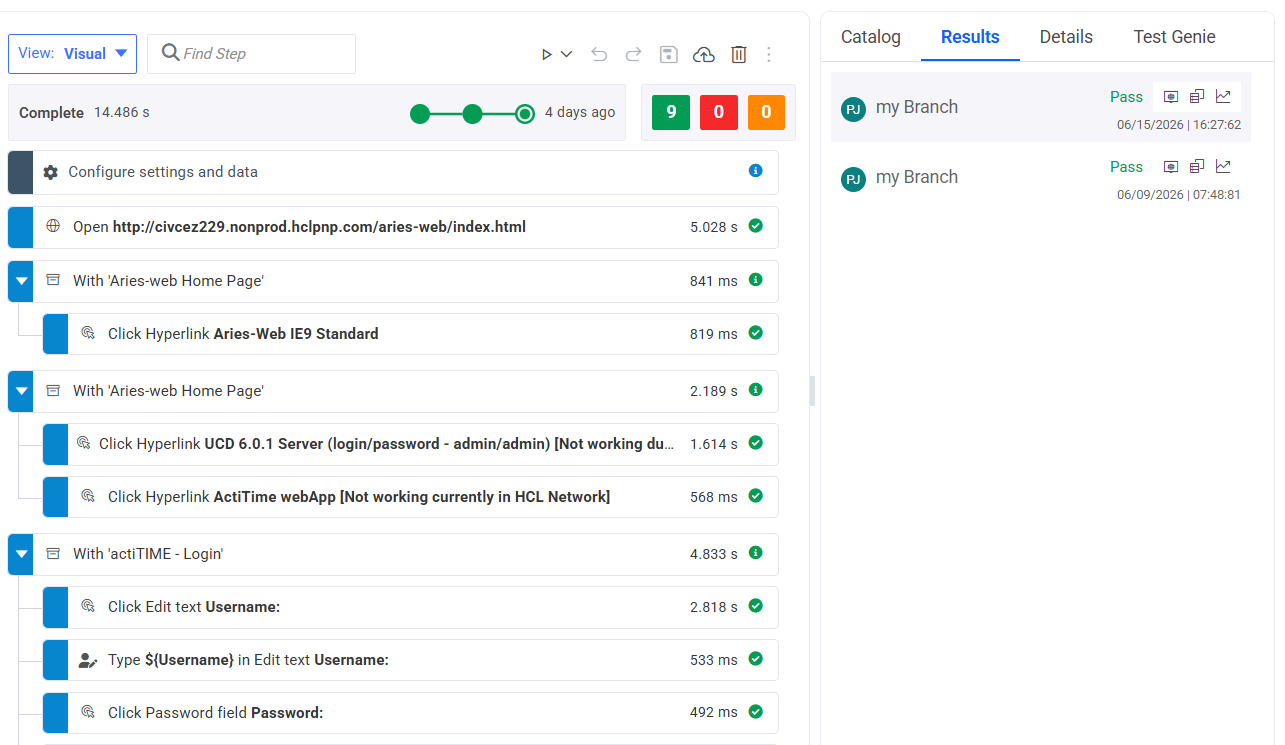

When you play back the test, the test runs in the browser that is used to record the test. The progress bar shows the progress of the test, while the three color-coded boxes display the counts of passed steps, failed steps, and errors. You can view the step details of the first failed step or error step by clicking the respective color-coded boxes. As the test runs, you can view checkmarks for the steps that pass and crossmarks for the steps that fail. After the test run is complete, you can view the overall results on the Results page.

  6. Click the Run icon icon, and then select the Run on Default Cluster option to begin the test run.
    You can also select the Run on Personal Agent option if the personal agent is in the ready state.
    You can view the following stages during the test run:
    • In transition: The test setup is in progress.
    • Running: The test run is active.
    • Complete: The test run is completed. This section also displays the time taken for test run.
    • During the Running phase, the following step result indicators are displayed with the time taken to process each step:
      • A checkmark check mark icon appears for the passed step.
      • An error mark error mark icon appears for the steps with an error.
      • A crossmark cross mark icon appears for the failed step.
      • An info icon info mark icon appears for the With step that indicates a new screen or window.
    • The Results tab displays the test as In Progress during the test run.
    • After the test run is completed, the Results tab displays the test as Pass or Fail.
    The Result page supports selecting individual items from the list. When a row is selected, the corresponding high-level information is displayed in the top banner of the Test Editor.
    Figure 1. Running a Web UI test
  7. Click image of an icon to open the Results page, where you can view the results, reports, and logs of the completed test run.
You have run a Web UI test.
