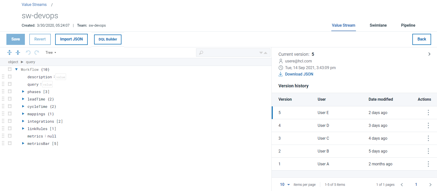

- On the Value Streams page, click the required value stream.
Click
and select Edit value stream map to open the VSM JSON code editor.
Note:The JSON code editor is the default view mode when you open the editor. -
On the right of the
icon above the code editor, click the Code or Tree view
drop-down and select Tree.
The JSON tree editor opens below the drop-down as shown in the figure below.Figure 1. JSON tree view
Note:In the Version history table on the right side of the display, the current version of the JSON shown on the left side of the display is indicated by a vertical blue bar next to the Version field in the table and is the file displayed and open in the editor.Note:The icons on the left side of the display above the Select a node breadcrumb bar include the following:- Click

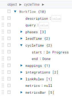

highlighted for identification. - When you click fields in the tree editor, a breadcrumb is displayed
in the Select a node section based on the
selected item in the tree view. For example, if you click
cycleTime in the tree editor, the
breadcrumb is shown in the following figure followed by details:
Figure 2. Select a node breadcrumb
- On the right side of object, click
to display the
object hierarchy drop-down list
shown in the following figure:
Note:Since cycleTime was selected, it is highlighted in the drop-down list. - Click cycleTime in the Select a node breadcrumb bar and that field is highlighted with a yellow rectangle in the editor.
- On the right side of cycleTime, click
to display the
cycleTime hierarchy drop-down
list shown in the following figure:
