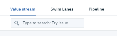

    You can also use DQL queries in search box available in value stream page to filter the required data.DQL searchbox
