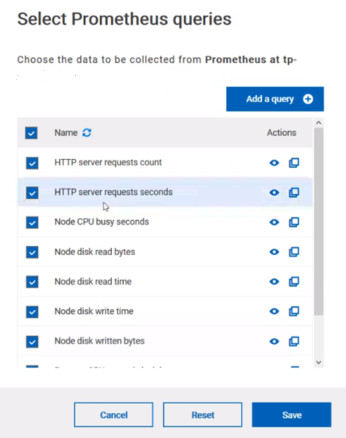

  3. In the Select Prometheus queries dialog, select queries that are available in the list to collect Prometheus metrics data by clicking the checkboxes.
    You can reset the selection.

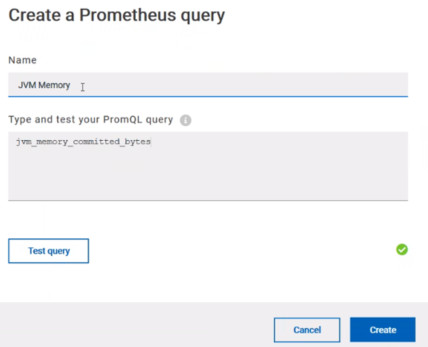

    1. Click Add a query.
    2. Enter a name for the new query in the Create a Prometheus query dialog.

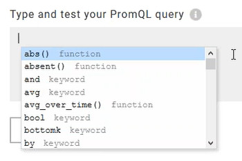

    3. Enter a PromQL query.any keyword and press Ctrl+Space in the Type and test your PromQL query.
      All the possible combinations of keywords and metrics related to your searched keyword are listed.
      Field where you can enter and test a PromQL query
    4. Select a query in the list.

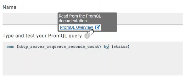

    5. Click the link that points to the 'Querying Prometheus documentation' page in the information tool tip to find other examples of queries in a web page that you can use as samples.
      Field where you enter a PromQL query
    6. Click Test query.
      If the test is successful, a green check is displayed, otherwise you get a red check with an error message.
    7. Click Create.

    6. Click Save to close the Select Prometheus queries dialog.
  7. Click Save and close the Select Prometheus queries dialog.
