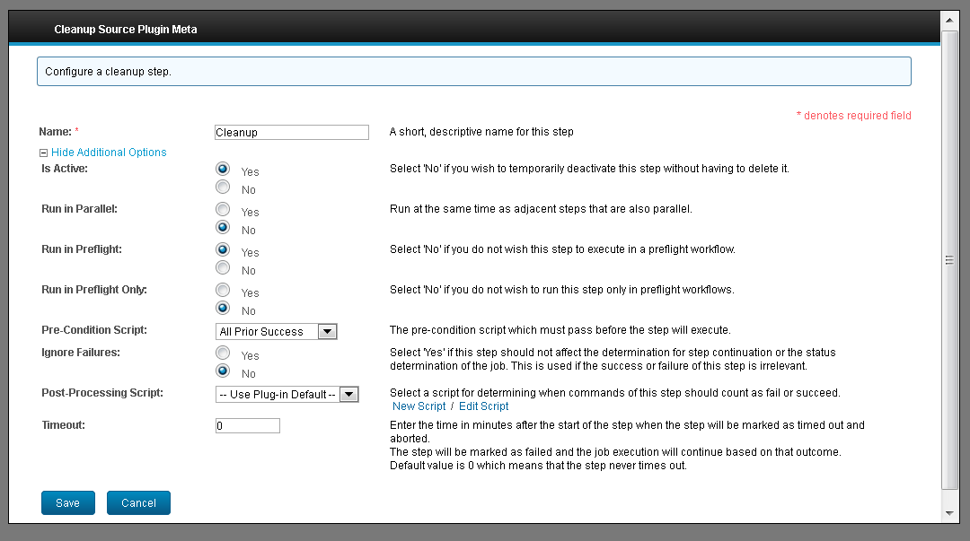

  4. In the Steps dialog box, click Clean Workspace, and then click Select.
    The Change Source dialog box is displayed. The dialog box that is displayed after you select a step contains options that are related to the selected step. Some of the options are unique to the step, while others are common to all steps.
    Note: Each step dialog box has more options available than are initially displayed. To see the other options, click Show Additional Options. The additional options are the same for all steps and are set to default values that are acceptable for most jobs. For example, the default value for the Pre-Condition Script field is All Prior Success, which means that the step runs only if the preceding steps succeed. The additional options are shown in the following figure. For most of the steps in this tutorial job, the default values are fine.Cleanup Source plug-in options
  5. On the Cleanup Source dialog box, in the Name field, type Cleanup.
  6. Click Save.
The Cleanup step is listed on the Main tab for the job.

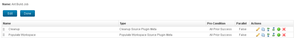

The Populate Workspace step is added to the job, as shown in the following figureThe Populate Workspace step added to the job

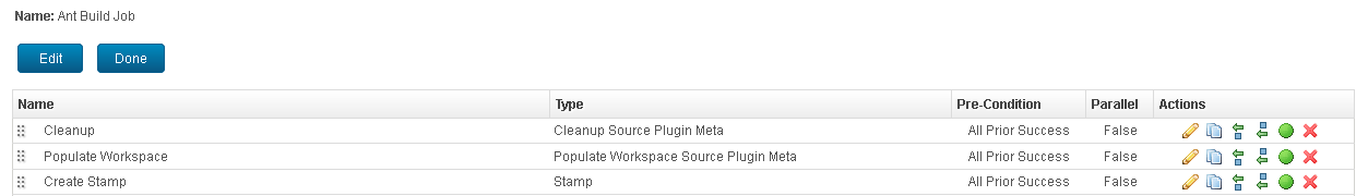

The Create Stamp step is listed on the Main tab for the job, as shown in the following figure:The Create Stamp step that is listed on the Main tab

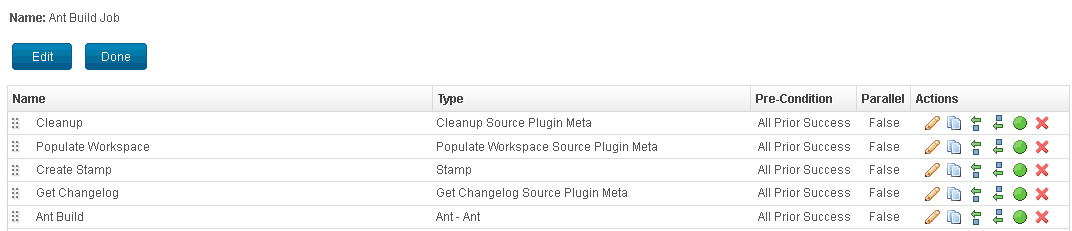

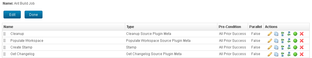

The Get Changelog step is inserted into the job after the Populate step, as shown in this figure:The Get Changelog step is inserted into the job.
Creating an Ant build step
Create a step that runs an Ant build process.
This step runs an Ant build. Like most steps, the Ant build step is defined by the properties that you specify. Many properties that you define for this step are placeholders and their values will be specified by other templates or at run time.
  1. Click the Insert After action for the Get Changelog step.
  2. In the Steps dialog box, click Build > Build Tools > Ant > Ant, and then click Select.
  3. In the Plugin Command window, in the Name field, type Ant Build.
  4. In the Working Directory Offset field, type ${p?:dir.offset}.
    The question mark character, ?, can be used to reference properties. The format is ${p?:propertyName}. In this instance, if the user specifies a value for the dir.offset property, this script returns the value. Otherwise, it returns an empty string.
  5. In the Ant Script File field, type ${p:build.script.name}.
  6. In the Targets field, type ${p?:ant.targets}.
  7. In the Properties box, type ${p?:build.properties}.
  8. In the Ant Properties box, type ${p?:ant.properties}.
    Note: The ANT_HOME and JAVA_HOME fields are set to default values for the computer where the agent is located.
  9. Click Save.
The Ant Build step is inserted into the job after the Get Changelog step, as shown in this figure:The Ant Build step inserted into the job

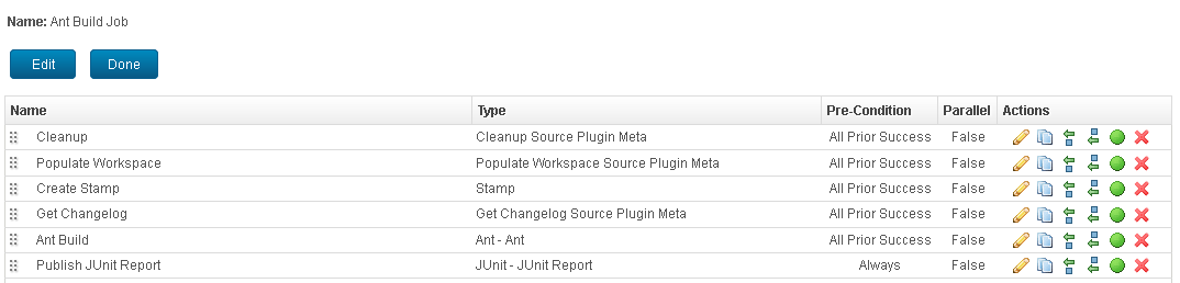

Creating the publish JUnit tests step
JUnit is a testing framework for Java. This step runs tests and reports the results.
Before you begin this lesson, make sure that you install the JUnit plug-in as described in Configure the tutorial system.
Unlike most of the other steps in the Ant Build job, this step is configured to always run even if the preceding step fails. Test reports are displayed on the Tests tab for build life.
  1. Click the Insert After action for the Ant Build step.
  2. In the Steps dialog box, click Quality > Unit Testing > JUnit, and then click JUnit Report.
  3. Click Select.
  4. In the Name field, type Publish JUnit Report.
  5. In the Report Name field, type JUnit Report.
  6. In the Source Directory field, type ${p:junit.report.base.dir}.
    Reports are written to the specified location.
  7. In the Include Patterns field, type TEST*.xml.
    Test files that match the specified pattern are written to the same directory.
  8. Display the Pre-Condition Script list by clicking Show Additional Options, and then select Always.
  9. Click Save.

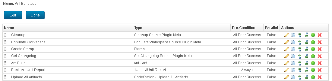

The Publish JUnit Report step is inserted into the job after the Ant Build step, as shown in this figure:The Publish JUnit Report step inserted into the job
Creating the upload artifacts step
Create a step that uploads the build artifacts into the artifact repository, CodeStation.
  1. Click the Insert After action for the Publish JUnit Report step.
  2. In the Steps dialog box, click Build Systems > CodeStation > >Upload All Artifacts, and then click Select.
  3. In the Name field, type Upload All Artifacts.
  4. Accept the default values for the other fields and click Save.
The Upload All Artifacts step is inserted into the job after the Publish JUnit Report step, as shown in this figure:The Upload All Artifact step inserted into the job

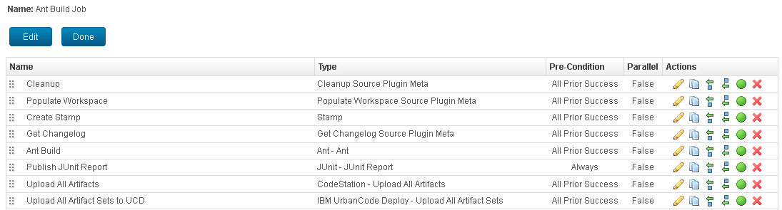

  1. Click the Insert After action for the Upload All Artifacts step.
  2. In the Steps dialog box, click Deploy > Tools > DevOps Deploy > Upload All Artifact Sets, and then click Select.
  3. In the Name field, type Upload All Artifact Sets to UCD.
  4. In the Component Name field, type ${p:project/name}.
    Note: This property value loads the artifacts into an Deploy component with the same name as the project that runs the build. Later you create a tutorial project that is named Ant. If you name your project something else, make sure that you name a component in Deploy with the name that you use for the project.
  5. In the Component Version field, type ${p:buildlife/latestStamp}.
    This value generates a version number for the Deploy component version. The component version ID that is created in Deploy is equal to the value that the Create Stamp job step creates.
  6. In the DevOps Deploy Server list, select the server that you integrated with Build.
  7. Accept the default values for the other fields and click Save.

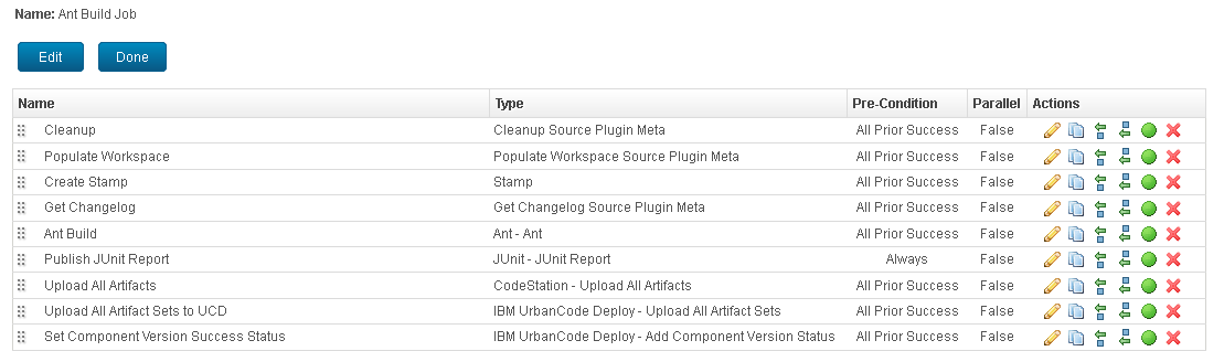

The Upload All Artifact Sets to UCD step is inserted into the job after the Upload All Artifacts step, as shown in this figure:The Upload All Artifact Sets to UCD step inserted into the job

  1. Click the Insert After action for the Upload All Artifact Sets to UCD step.
  2. On the Steps dialog box, click Deploy > Tools > DevOps Deploy > Add Component Version Status, and then click Select.
  3. In the Name field, type Set Component Version Success Status.
  5. In the Version Name field, type ${p:buildlife/latestStamp}.
  6. In the Status Name field, type Success.
    The status value is applied to the component version that was created in the previous step.
  7. In the DevOps Deploy Server list, select the server that you integrated with Build.
  8. Accept the default values for the other fields and click Save.
The Set Component Version Success Status step is inserted into the job after the Upload All Artifact Sets to UCD step, as shown in this figure:The Set Component Version Success Status step inserted into the job

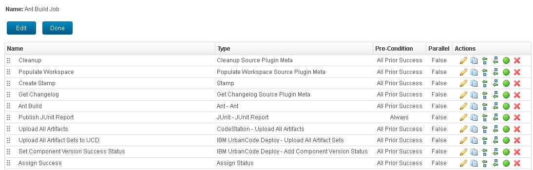

Creating the assign success step
If all previous steps succeed, this step assigns a status of Success to the entire job. If the preceding steps fail, this step does not run, and the next step runs instead.
  1. Click the Insert After action for the Set Component Version Success Status step.
  2. In the Steps dialog box, click Build, and then click Assign Status.
  3. In the Name field, type Assign Success.
  4. In the Status list, select Success.
  5. Click Save.
    Because the Pre-Condition Script field is set to All Prior Success by default, you can accept the value.
The Assign Success step is inserted into the job after the Set Component Version Success Status step, as shown in this figure:The Assign Success step inserted into the job

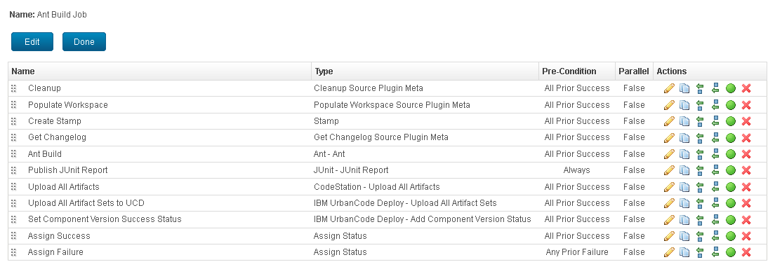

The Assign Failure step is inserted into the job after the Assign Success step.
Lesson checkpoint
In this lesson, you created job and added steps to it.
This job retrieves source from GitHub and runs an Ant build process on it. It uploads the artifacts into HCL DevOps Deploy (Deploy) and generates JUnit test reports. Steps are configured individually as you insert them into a job.
The steps for the completed Ant Build Job are shown in this figure:The finished Ant Build Job
