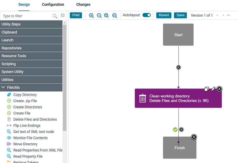

  6. Add a step to clean any files out of the working directory.
    The process runs within a working directory. To ensure that you are using the most recent version of the files in the web component, run a command to clean the working directory:
    1. At the left of the process editor, in the step palette, expand Utilities.
      The step palette menu shows the available steps. You can explore the palette categories to find steps, or you can type in the search box at the top of the window.
    2. Under FileUtils, click and drag the Delete Files and Directories step to the process editor.
      The step is inserted between the Start and Finish steps. The inserted step is automatically connected to these steps Edit Properties window opens, showing the properties for the step. Some of these properties are unique to the step and others are the same for all steps.
    3. Click the Edit icon , and the Edit Properties window opens. In the Name field, specify the name to be Clean working directory.
    4. In the Base Directory field, specify a single period (.).
    5. In the Include field, specify the following code:
    6. Accept the defaults for the other properties and then click OK.
    The new step is displayed as a box in the process editor. The process editor looks like the following figure:
    The new process with one step in the flow

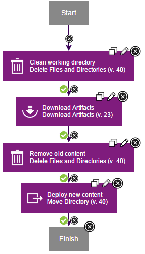

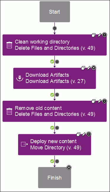

    Now the process has four steps, as in the following figure:
    The four steps of the process, which are placed in order between the Start and Finish steps
Each step has three icons at the upper right corner of the step. The Edit icon opens the Edit Properties window. The X icon deletes the step. The Copy icon copies the step to the Clipboard folder so you can duplicate it.
Also, if you move the mouse over a step, an arrow icon is displayed over the center of the step. This icon is used to manually create links between steps.
Displaying the arrow button at the center of the step
  1. Optional: If your steps are not connected or are not connected in the correct order, you can connect the steps manually:
    1. If the steps are not in the correct order, remove the connection link between steps by clicking the X icons on any of the link arrows; then, rearrange the steps in the correct order.
    2. Move the mouse over the Start step, and drag the arrow icon to the Clean working directory step.
      The arrow between these steps represents the flow of activity from one step to another, as in the following figure:
      The link that connects the Start step to the Clean working directory step
    3. Similarly, drag an arrow from the Clean working directory step to the Download Artifacts step.
    4. Drag an arrow from the Download Artifacts step to the Remove old content step.
    5. Drag an arrow from the Remove old content step to the Deploy new content step.
    6. Drag an arrow from the Deploy new content step to the Finish step.
    You can connect steps in a sequence like these steps, or you can run steps in parallel with each other by creating more links. However, processes always start with the Start step and end with the Finish step. The sequence of steps in this process is as follows:
    1. Start
    2. Clean working directory
    3. Download Artifacts
    4. Remove old content
    5. Deploy new content
    6. Finish
  2. Save the process by clicking Save.
The complete component process for the web component looks like the following figure:
The complete component process, which removes the old version of the artifacts and deploys the new version to the application server

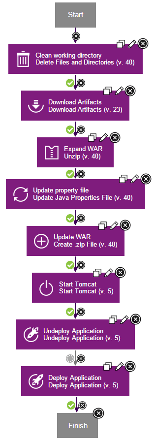

  14. Optional: If required, arrange and connect the steps in the following order:
    1. Start
    4. Expand WAR
    5. Update Property File
    6. Update WAR
    7. Start Tomcat
    8. Undeploy Application
    9. Deploy Application
    10. Finish
  15. Change the conditional flag on the link between the Undeploy Application and Deploy Application steps to both by clicking the green check mark on the connection until it turns to a gray circle, as shown in the following figure:
    Clicking the green check mark between the Undeploy Application and Deploy Application steps to turn it to a gray circle
    Each connection from one step to another has a conditional flag. The conditional flag specifies a condition for the connection. Three conditional flags are available:
    • By default, the conditional flag on each connection is set to success, which is represented by a green check mark. The process follows these connections when the step succeeds.
    • The conditional flag fail is represented by an exclamation point (!) in a red field. The process follows these connections when steps fail.
    • The conditional flag both is represented by a gray circle. The process follows these connections regardless of whether a step succeeds or fails.
    The Undeploy Application step fails if no previous versions of the application are installed. In this case, setting the conditional flag on the connection to both specifies that the process keeps running regardless of whether the step fails or succeeds.
  16. Save the process.
The complete component process for the application component looks like the following figure:
The complete component process that deploys the application

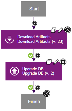

Creating a component process for the database component
The deployment process for the database component updates the database with sample values.
  1. From the Components tab, click the JPetStore-DB component.
  2. Click Processes, and then click Create Process.
  3. In the Create Process window, specify the name as Deploy component.
  4. In the Process Type list, select Deployment.
  5. Accept the default values for the other properties, and click Save.
  6. In the process editor, add a step to download the artifacts.
    As you did for the web component, add a Download Artifacts step, and accept the default properties.
  7. Add a step to update the database:
    You must create a database version table on every target database either manually before you run the DBUpgrader plug-in steps for the first time or as part of the first change.
    1. In the list of available steps, expand Database, and under DBUpgrader, add an Upgrade DB step to the process editor.
      If this step is not in the tree, install the database upgrade plug-in as described in the Prerequisites for this tutorial.
    2. In the Edit Properties window, in the Name field, accept the default value of Upgrade DB.
    3. In the Driver Classname field, specify the following class:
      com.mysql.cj.jdbc.Driver
    4. In the DB Driver Jar field, specify the following path:
      lib/mysql-connector-j-8.0.33.jar
      This file is provided in the source code for the component.
    5. In the URL field, specify the following variable:
      ${p:environment/db.url}
    6. In the User field, specify the user ID of the database user.
      If you used the examples in Configuring the agent and target system, the user ID is jpetstore.
    7. In the Password field, specify the password of the database user.
      If you used the examples in Configuring the agent and target system, the password is jppwd.
    8. In the SQL File path field, specify a single period: . .
    9. In the SQL File Include field, specify the extension *.xml .
    10. In the Current Version SQL field, specify the following SQL code:
      SELECT VER FROM DB_VERSION WHERE RELEASE_NAME = ?
    11. In the Delete Version SQL field, specify the following SQL code:
      DELETE FROM DB_VERSION WHERE RELEASE_NAME = ?
    12. In the Update Version SQL field, specify the following SQL code:
      INSERT INTO DB_VERSION (RELEASE_NAME,VER) VALUES(?,?)
    13. Click OK.
  8. Optional: If required, arrange and connect the steps in the following order:
    1. Start
    2. Download Artifacts
    3. Upgrade DB
    4. Finish
  9. Save the process.
The complete component process for the database component looks like the following figure:
The complete component process that deploys the database
In this lesson, you created component processes to deploy the components.
