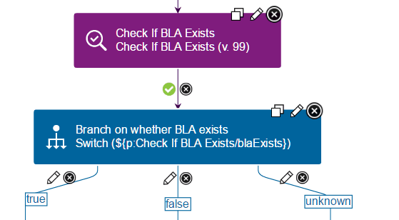

blaExists
output property:

example:properties.setProperty("url", "http://example.com"); blaExists output property by using the code
${p:Check If BLA Exists/blaExists}:
You can use output properties in other postprocessing scripts, step preconditions, step properties, or the code of steps themselves. Passing property values among processes, resources, and steps helps limit the requirement to provide input manually and to maintain accuracy and reliability.
