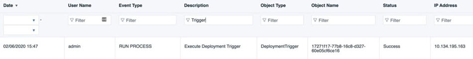

The default audit view is as follows:
  • When the deployment trigger is created and who created it
  • When the deployment trigger is deleted and who deleted it
Audit trailAudit trail

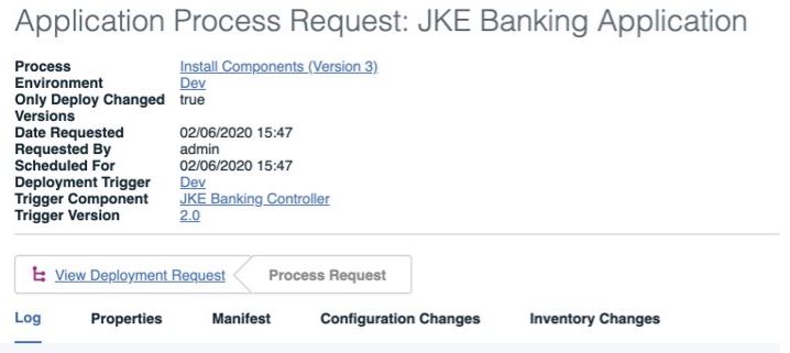

An application process that requires approvals is still kicked off when a deployment trigger runs the process.
When you update component versions on the command-line interface, a deployment trigger runs when the import is finished.
