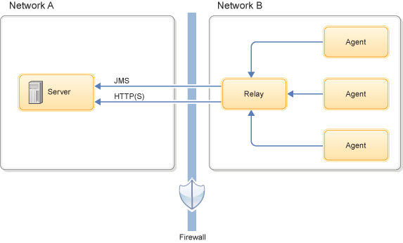

The following figure is a simple diagram of communication between agents, an agent relay, and the server across a firewall. The agents connect directly to the agent relay, and the agent relay is the only system that connects to the server through the firewall.
A diagram of how an agent relay enables agents to communicate with a server through a firewall

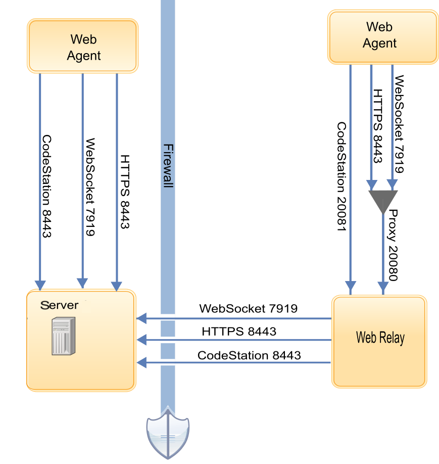

Agent relays open the connections to the Deploy server; the server never opens connections to the agent relays. Agents open the connections to the agent relay; the agent relay never opens connections to the agent. Agent to server communication is always encrypted. HTTP 20080 port is used to establish a tunnel between agent and server to transfer encrypted data. By default, agent relays open connections on the following ports for communication:
  • 8080 and 8443 for HTTP and HTTPS connections to the server
Agent relays accept connections on the following default ports:
  • 20080 for HTTP proxy connections from agents.
  • 20081, the encrypted port, for artifact cache requests from agents.

The following diagram shows the main default ports that are involved in communication between agents, agent relays, and the server.
A diagram of the ports that agents, agent relays, and servers use to communicate; these are the same posts in the lists above
