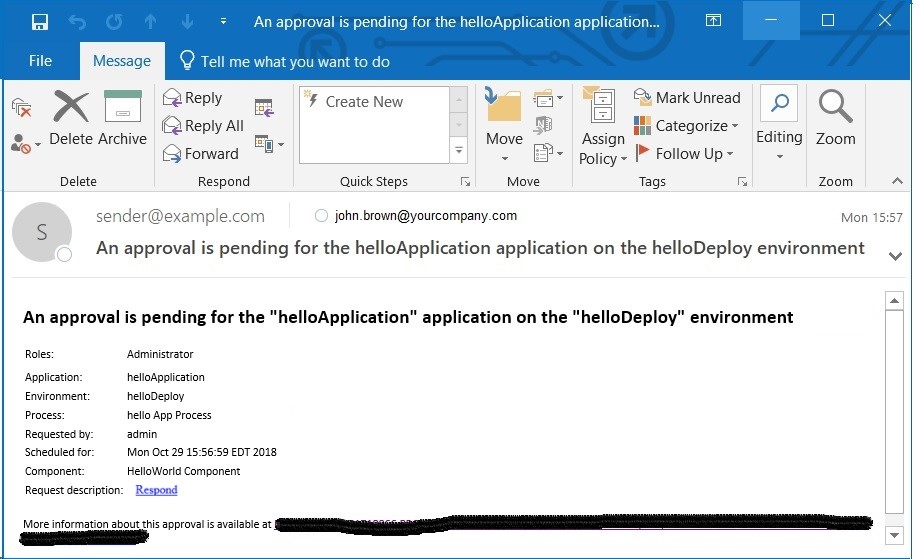

    When the process runs, the approver is notified with an e-mail that an approval is required. An example of a default ApprovalCreated notification template is shown below.
    Example ApprovalCreated Notification Template

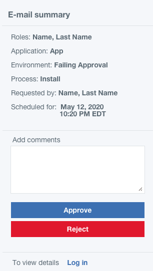

    The e-mail notification includes the Respond option that directs the approver to the E-mail summary page. An example of the E-mail summary page is shown below:
    e-mail summary
    This allows the approver to take appropriate action without logging into the Deploy.
