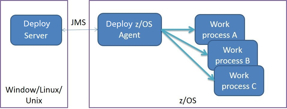

The Deploy IBM® z/OS® agent is a long running Java process in the IBM® z/OS® UNIX System Services. The Deploy server distributes work, known as deploy processes, to an agent to execute. For each step in the deploy process, the agent starts a separate work process. The work process inherits the agent user ID’s security environment, unless the process is configured to use impersonation.
Figure 1. z/OS Server Agent Architecture
z/OS Server Agent Architecture diagram

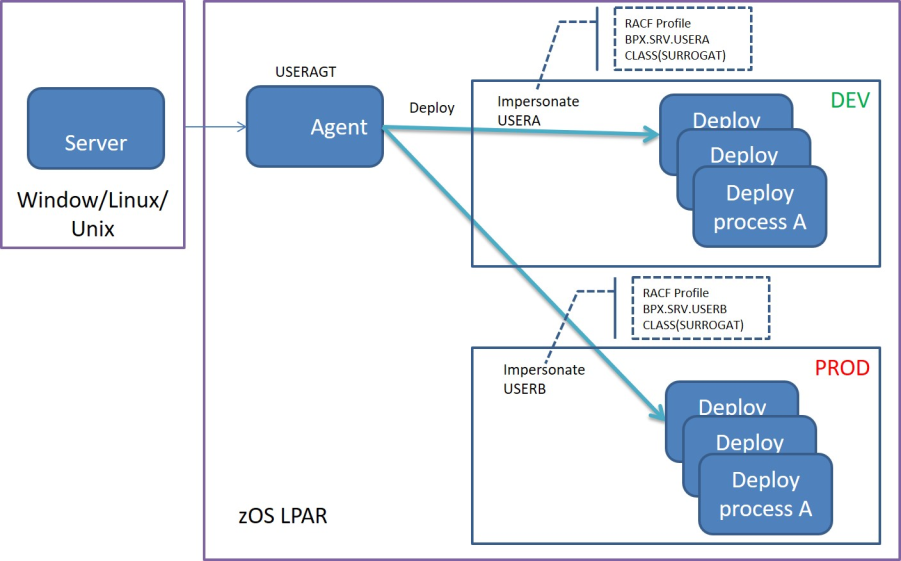

The su command is used to impersonate users. This figure shows a deployment scenario with two logical environments, DEV and TEST, in the same logical partition (LPAR). The deployment process is configured so that the agent impersonates USERA when deploying to DEV and USERB when deploying to TEST.
Figure 2. z/OS Impersonation
z/OS Impersonation diagram
