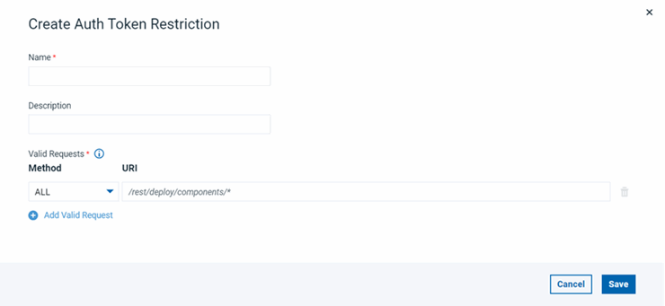

  1. On the server, click Settings > Token Restrictions.
  2. On the Token Restrictions pane, click Create Auth Token Restriction.
  3. In the Create Auth Token Restrictions dialog box, in the Name field, enter a name for the token restriction.
  4. In the Description field, enter a description for the restriction.
  5. Define one or more requests by completing the following steps:
    1. In the Method list, select the request verb.
    2. In the URI field, paste or enter the URI. The URI must start with the forward-slash character "/". You can use the asterisk (*) wildcard as the last character in the URI. For example, the following request allows information to be retrieved from all REST services:
      Sample token restriction
    3. If you want to define another request, click Add; otherwise, click Save.
