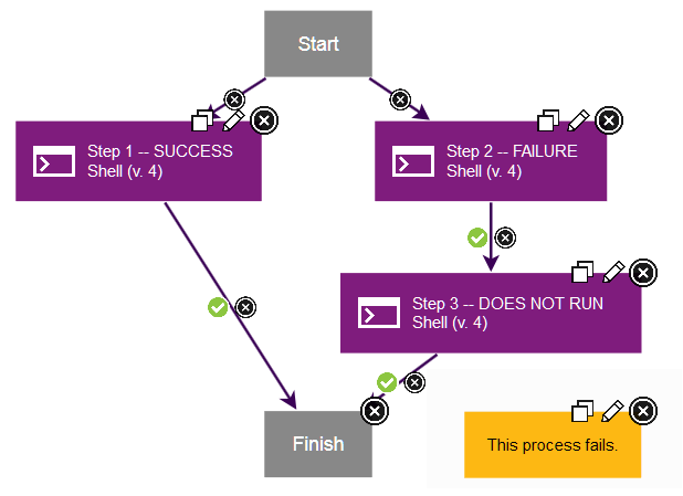

How you branch and merge steps can change whether the process finishes or fails. For example,
the following process has three steps. Step 1 runs on its own parallel path. In another parallel
path, step 2 runs first and then links to step 3. Step 1 and step 3 then connect to the Finish step.
If step 2 fails, step 3 does not run. Because step 2 failed, the entire branch is invalid, and the
process fails.

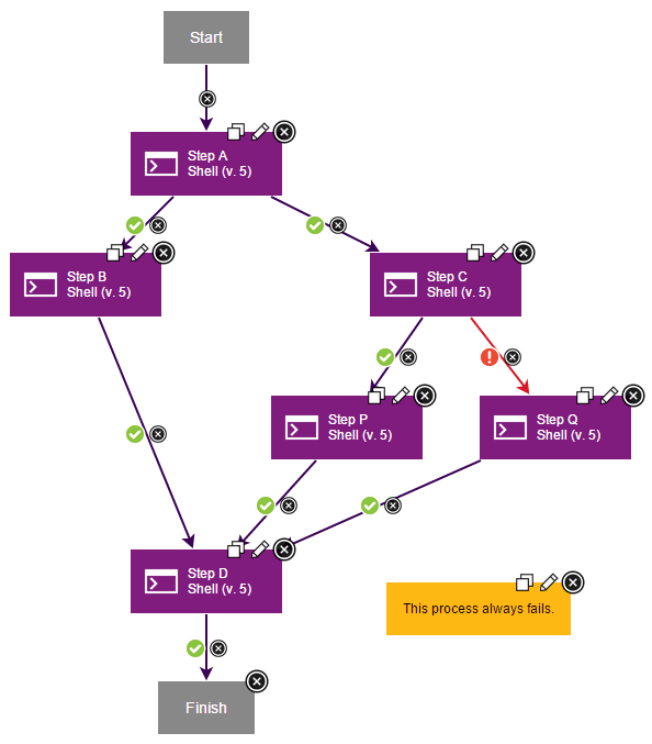

Your process can include nested parallel paths, but you must carefully plan how the parallel
paths merge. The rules for the success
and failure
flags that you
assign at the branching step control how the parallel paths must merge. If you mark all the steps at
the branching step with success
flags, then all the steps that are attached to the
merging step must succeed.
The
following process contains two branching steps but only one merging
step. Because both branches from step A have
success
flags,
all the steps that merge at step D must succeed for it to run. Step
P runs only if step C succeeds and step Q runs only if step C fails.
Because both step P and step Q merge at step D, it is impossible for
all the steps that join at step D to succeed. This process always
fails.

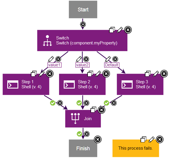

Branching and joining with the Switch and Join step
Use
a Join step to explicitly indicate that all connections to the Join
step must succeed. The Join step fails if any of the connections to
it fail or do not run. For example, the following process uses a Switch
step to branch the process. The Switch step has three outgoing connections,
each for a different possible value of a property. Thus, only one
of these outgoing connections runs. The three outgoing connections
are merged at a Join step. The Join step always fails because only
one of the outgoing connections runs. The two other step chains do
not run, and therefore the Join step fails.
In these cases, when you
do not intend for each step chain to run, do not use a Join step.
Instead, merge the step chains by connecting the chains to a single
step, as shown in the following process.
