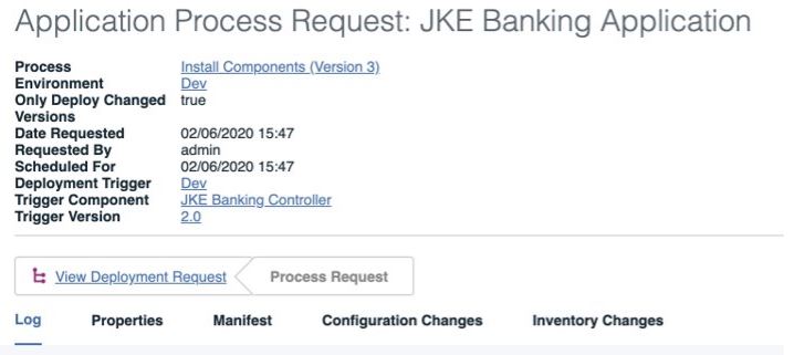

Deployment Triggers are ways for environments to subscribe to certain components. A trigger consists of a specified component, deployment process, and user. Whenever a component finishes importing a version, the server will automatically execute all deployment triggers relevant to that component and will run configured deployment processes against the triggers’ environment, using the newly imported version as the deployment payload. With deployment triggers, development environments can be configured to get the latest build artifacts deployed as soon as they are received by the HCL Launch server.
When you create a deployment trigger, you have to specify a user who has the run deployment triggers permission, but you do not require that permission yourself. Run deployment triggers is a system level permission that governs whether the a user is allowed to run the process that is the trigger specifies
The user who runs the deployment trigger also must have all permissions that are required to run an application process. Like the run deployment triggers permission, these permissions are also asserted at process run time and not when the trigger is created.

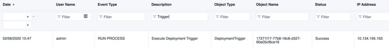

The default audit view is as follows:
  • When the deployment trigger is created and who created it
  • When the deployment trigger is deleted and who deleted it
Audit trailAudit trail

Before the deployment trigger request submission succeeds submitted, these conditions must be met:
  • The component must be mapped to the application when the deployment trigger submits the process request.
  • The application process and component must not be deleted.
  • The user who runs the deployment must have run deployment triggers permission when deployment trigger runs.
If the user who runs a deployment trigger does not have the required role for a process, then the application process cannot start the deployment by using the deployment trigger.
