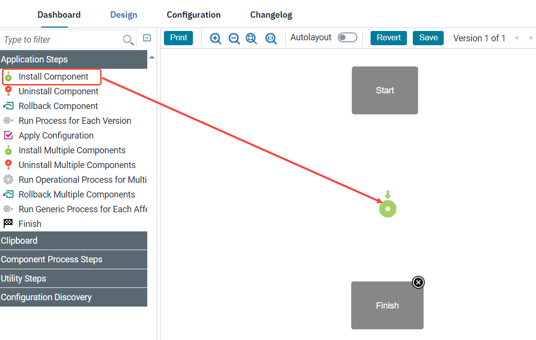

  2. To add a step:
    1. From the list of steps at the left of the window, drag the step to use onto the design space.
      Adding a step by dragging it from the list of steps to the design space

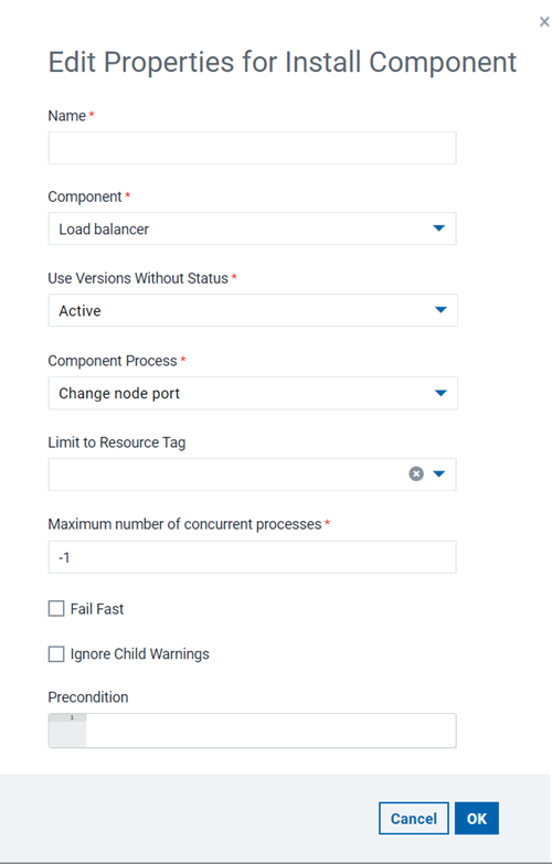

      To open the Edit Properties window, click the edit properties icon The edit properties icon. When you drag the first property on the design pane, you can place the step anywhere on the design space. Connection links are automatically created from the Start node to the step and from the step to the Finish node. When you add more steps, drag them and position them so that they highlight the connection link between stesps so that the step is inserted and connection links are automatically created between the steps. Steps can be dragged and positioned at any time. However, you must delete the connection links from the step by clicking the delete connection icon delete connection icon, and then reconnect the moved steps.
      A typical Edit Properties window, showing the properties for the step
      Configuration dialogs boxes are tailored to the selected step. Only parameters that are associated with the step type are displayed.
    2. Specify the properties for the step.
      Each step has different properties. See Plug-ins for information about configuring specific steps.

    4. After you configure the step properties, save the step by clicking Save.

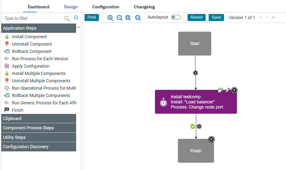

    The step is in the design space and is connected to other steps. If you change your mind, click Cancel to remove the step from the design space.
  3. Verify that the step connections create the required process flow:
    Connections control the process flow. The originating step runs before the target step. If you move steps or do not highlight a connection link when you place a step, creating a connection between steps is a simple process. You drag a connection from the originating step to the target step. Connections are typically formed automatically. However when you create them manually, connections are formed one at a time between two steps, the originating step and the target step. To create connections manually:

    The connection between two steps and the conditional flag for the connection
    Each connection has a connection delete tool, conditional flag, and might have other tools depending on the originating step. Remove a connection by clicking the delete tool.
