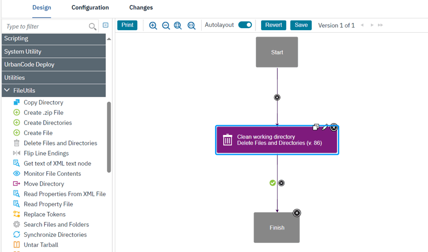

    1. At the left of the process editor, in the step palette, expand Utilities.
      The step palette menu shows the available steps. You can explore the palette categories to find steps, or you can type in the search box at the top of the window.
    2. Under FileUtils, click and drag the Delete Files and Directories step to the process editor.
      The step is inserted between the Start and Finish steps. The inserted step is automatically connected to these steps Edit Properties window opens, showing the properties for the step. Some of these properties are unique to the step and others are the same for all steps.
    3. Click the Edit icon , and the Edit Properties window opens. In the Name field, specify the name to be Clean working directory.
    4. In the Base Directory field, specify a single period (.).
    5. In the Include field, specify the following code:
    6. Accept the defaults for the other properties and then click OK.
    The new step is displayed as a box in the process editor. The process editor looks like the following figure:
    The new process with one step in the flow

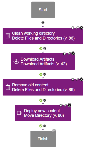

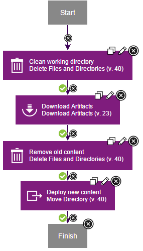

    Now the process has four steps, as in the following figure:
    The four steps of the process, which are placed in order between the Start and Finish steps

The complete component process for the web component looks like the following figure:
The complete component process, which removes the old version of the artifacts and deploys the new version to the application server

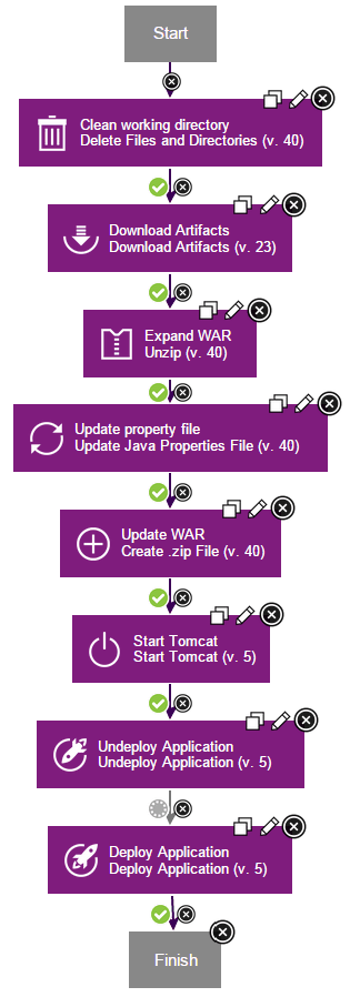

  11. Add a step to start Tomcat:
    1. In the list of available steps, expand Application Server, and from Java/Tomcat, add a Start Tomcat step to the process editor.
      If this step is not in the tree, install the Tomcat plug-in as described in the Prerequisites for this tutorial.
    2. Accept the default name Start Tomcat.
    3. In the Launcher field, specify the following code:
      ${p:environment/tomcat.start}
      This code is another variable that represents the command to start Tomcat.
    4. In the Startup timeout (in seconds) field, specify 60.
    5. In the Port field, specify the port 8081.
    6. In the Catalina Home field, specify the home directory where the Apache Tomcat is installed.
    7. Click OK.
  12. Add a step to remove any previous versions of the application:
    1. In the list of available steps, expand Application Server, and from Java/Tomcat, add an Undeploy Application step to the process editor.
    2. Accept the default name Undeploy Application.
    3. In the Tomcat Manager URL field, specify the following code:
      ${p:environment/tomcat.manager.url}
    4. In the Tomcat Manager User Name field, specify the user name for the Tomcat server.
      You specified this user name and its password in Configuring the agent and target system. If you used the code examples from that topic, the user name and password are tomcatmanager.
    5. In the Tomcat Manager Password field, specify the password for the Tomcat server.
    6. In the Context Name field, specify the following context name, including the preceding forward slash:
      /${p:environment/tomcat.contextroot}
      Ensure that you include a slash (/) before the variable.
    7. Click OK.
  13. Add a step to deploy the updated WAR file to the application server:
    1. In the list of available steps, expand Application Server, and from Java/Tomcat, add a Deploy Application step to the process editor.
    2. Accept the default name Deploy Application.
    6. In the Context Name field, specify the following context name:
    7. In the War File Path field, specify the following path:
      ./JPetStore.war
    8. Click OK.
  14. Optional: If required, arrange and connect the steps in the following order:
    1. Start
    2. Clean working directory
    3. Download Artifacts
    4. Expand WAR
    5. Update Property File
    6. Update WAR
    7. Start Tomcat
    8. Undeploy Application
    9. Deploy Application
    10. Finish
  15. Change the conditional flag on the link between the Undeploy Application and Deploy Application steps to both by clicking the green check mark on the connection until it turns to a gray circle, as shown in the following figure:
    Clicking the green check mark between the Undeploy Application and Deploy Application steps to turn it to a gray circle
    Each connection from one step to another has a conditional flag. The conditional flag specifies a condition for the connection. Three conditional flags are available:
    • By default, the conditional flag on each connection is set to success, which is represented by a green check mark. The process follows these connections when the step succeeds.
    • The conditional flag fail is represented by an exclamation point (!) in a red field. The process follows these connections when steps fail.
    • The conditional flag both is represented by a gray circle. The process follows these connections regardless of whether a step succeeds or fails.
    The Undeploy Application step fails if no previous versions of the application are installed. In this case, setting the conditional flag on the connection to both specifies that the process keeps running regardless of whether the step fails or succeeds.
  16. Save the process.
The complete component process for the application component looks like the following figure:
The complete component process that deploys the application

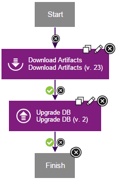

  8. Optional: If required, arrange and connect the steps in the following order:
    1. Start
    2. Download Artifacts
    3. Upgrade DB
    4. Finish
  9. Save the process.
The complete component process for the database component looks like the following figure:
The complete component process that deploys the database
