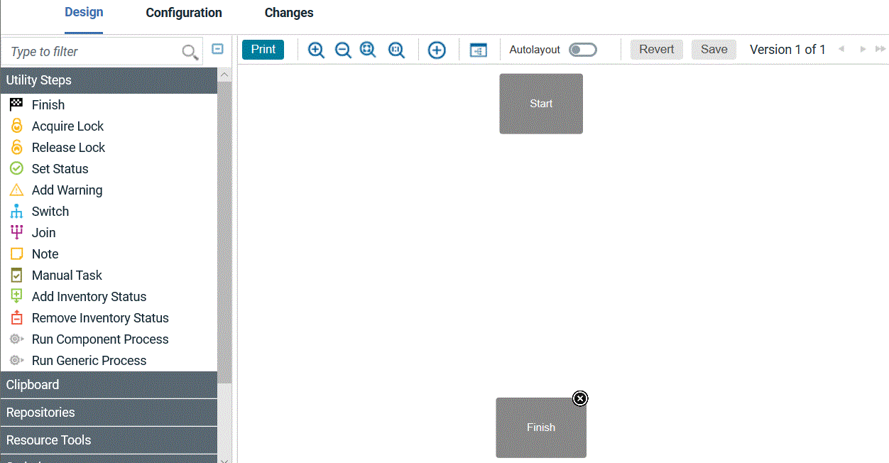

  2. Open the helloProcess process editor and go to Design.
    The process editor lists plug-ins and steps. The required Start and Finish steps represent the beginning and the end of the process and are automatically placed on the design area. You add steps to the process by dragging them onto the design area and arranging them between the Start and Finish steps.
    The process design editor

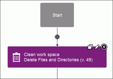

    The new step is displayed in the design area. Each step has two icons at the upper-right corner of the step. Click the Edit icon to reopen the Edit Properties window where you can modify the step properties. Click the X icon to delete the step and connections to or from it.
    The new process with one step
    The Start and Finish steps are automatically connected to the step.

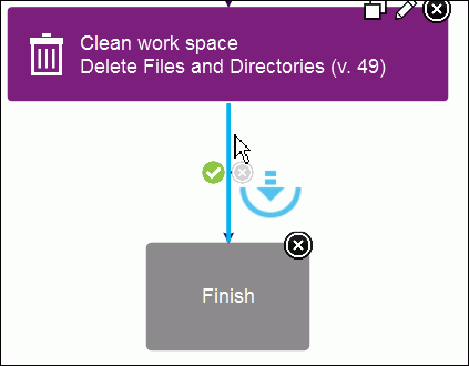

      Be sure to highlight the connection arrow when you drag the step to the process editor so that connection arrows are automatically inserted from the previous step to the Finish step. See the highlighted connection arrow in this illustration: Highlighted connection arrow as a step is dragged to the process editor

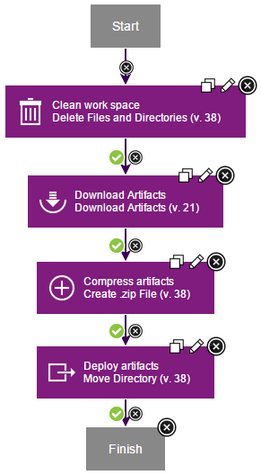

The complete process for the helloWorld component looks like the following figure:
In this lesson, you created a component process to deploy the helloWorld component.
