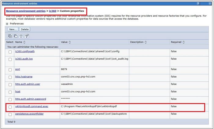

Enter the WebSphere administrative console (e.g.: https://your.dmgr.host:9043/ibm/console) and navigate to
Resources > Resource Environment > Resource Environment entries
Look for the
ic360
resource environment entry and click on it -
Navigate to
Additional Properties > Custom properties
Click New... to create a new property
Enter the name
wkhtmltopdf.command.exec
and the path to the wkhtmltopdf binary (including its name) as the value, e.g.C:\Program Files\wkhtmltopdf\bin\wkhtmltopdf.exe
on Windows or/opt/HCL/Connections/wkhtmltox/bin/wkhtmltopdf
on Linux. -
Click Apply and OK.
Save the changes to the master configuration.
Restart ICXT server.

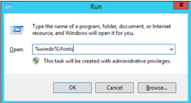

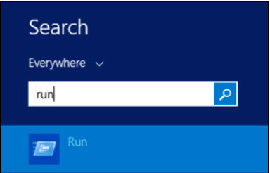

Login as Administrator and Click "Start"
Search for "run"
- Enter
%windir%\fonts

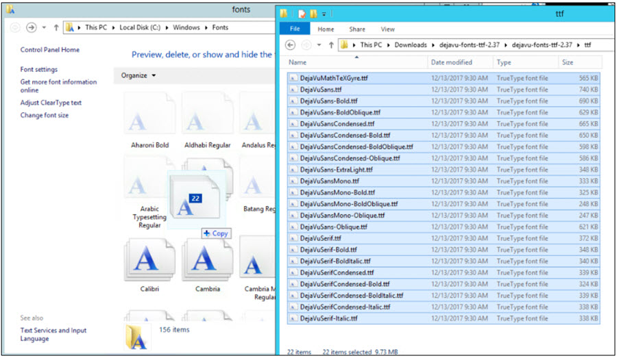

- Drag and drop the extracted fonts from the ttf folder to the Fonts config window
