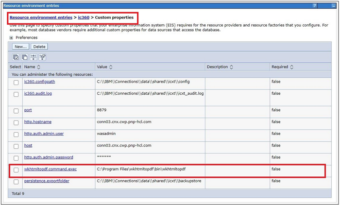

Configure PDF Export to invoke wkhtmltopdf in the correct install location
If wkhtmltopdf is not available by invoking the command listed in 2.1, you can instead make the PDF Export aware of what execution command is necessary to invoke it instead. For example, if you have installed the feature at location
/opt/HCL/Connections/wkhtmltox/bin/wkhtmltopdfyou can add this via WebSphere configuration. Perform the following:
Enter the WebSphere administrative console (e.g.: https://your.dmgr.host:9043/ibm/console) and navigate to
Resources > Resource Environment > Resource Environment entries -
Look for the
ic360resource environment entry and click on it -
Navigate to
Additional Properties > Custom properties -
Click New... to create a new property
Enter the name
wkhtmltopdf.command.execand the path to the wkhtmltopdf binary (including its name) as the value, e.g.C:\Program Files\wkhtmltopdf\bin\wkhtmltopdf.exeon Windows or/opt/HCL/Connections/wkhtmltox/bin/wkhtmltopdfon Linux. -
Click Apply and OK.
Save the changes to the master configuration.
Restart ICXT server.

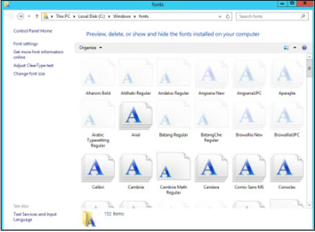

The documentation at https://support.microsoft.com/en-us/help/314960/how-to-install-or-remove-a-font-in-windows can be used for reference when installing the fonts. Generally, the required steps are:
Download and unzip the latest DejaVu fonts ZIP archive
Login as Administrator and Click "Start"

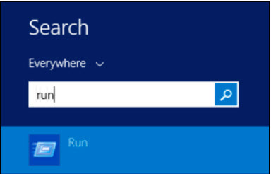

Search for "run"

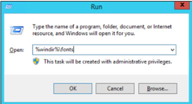

- Enter
%windir%\fonts

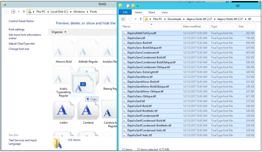

- Drag and drop the extracted fonts from the ttf folder to the Fonts config window
