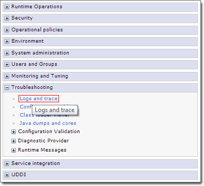

Click Troubleshooting > Logs and trace.

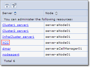

Click the Cluster/ AppServer, where you have mapped and installed the Connections Engagement Center application.

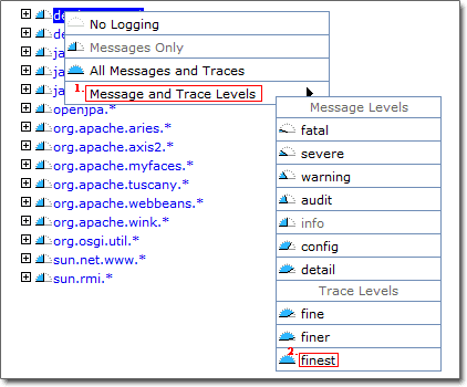

In the list that appears, search the list section de.timetoact.*.
9 |
Click de.timetoact.* and a pop-up menu menu appears. Sometimes it may happen that you have to scroll to the bottom of the page to see the pop-up window. Now click Message and Trace Levels and then select finest.
10 |
Click Apply.
